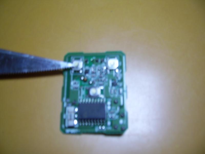

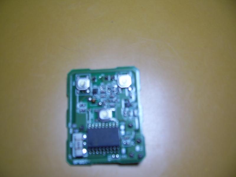

As I said earlier this has the 3 micro switches on the board, and NOT the touch pads with carbon contacts in the membrane, very old school. Found some replacement "micro switches" on ?bay last night, ex UK for $5, so on their way, just need a new seeing eye dog and STEADY hands to solder them to the circuit board. Fun will be had.
Couple of snaps just because.
The basic board as removed from the fob.
The point of the steak knife indicating 1 of the 3 switches I am mentioning above.
As I said, very old school.
