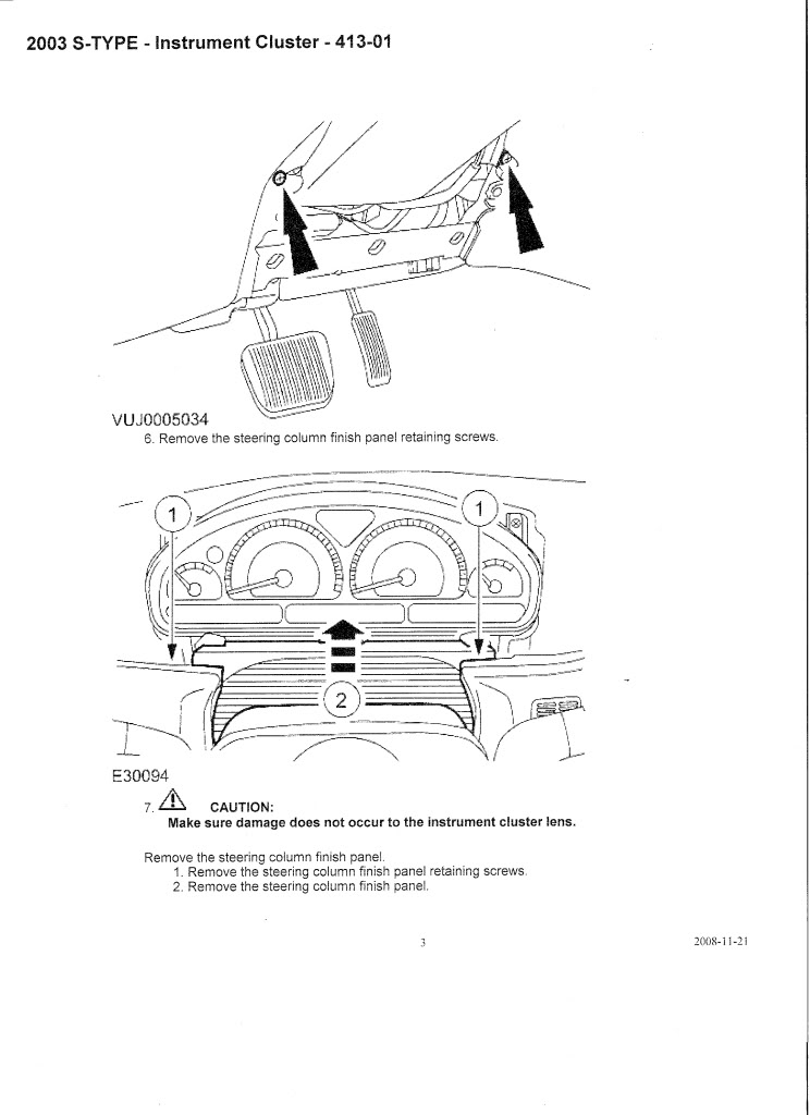

Look around and did a search but I can't find instructions on the removal of the instrument cluster, Can anybody help?

These instructions should help.......

Thank very helpful.....

This is the only diagram and instructions I could find on the net, Thanks!!
