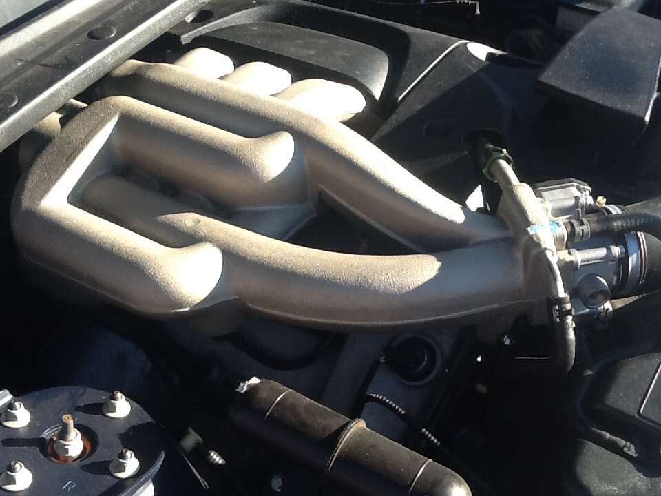

Where can I get the correct parts for the intake manifold, I have already replace the drivers side spark plugs ( Bosch platinum/iridium quad electrodes spark plugs). I thought the gaskets for the intake manifold are the same for both sides of the intake but when looking at a couple of jaguar sites, I see a lower and upper gasket....upper not available but lower was, what is the difference? I am wanting to use oem if possible or a higher end quality version.

It is confusing, to say the least. What some sites call the "lower intake gasket" is actually the gasket between the cylinder head and the plastic manifold that holds the fuel injector. What is sometimes called the "plenum gasket" is actually the upper gasket that seals the large aluminum air tube assy to the top portion of the plastic plenum.
Go to www.rockauto.com and pay attention to your body number, you should find it easy to get the right gaskets. Consider doing the valve cover gaskets while you are at it and even on a 2008, I'd suggest replacing the breather hose.
