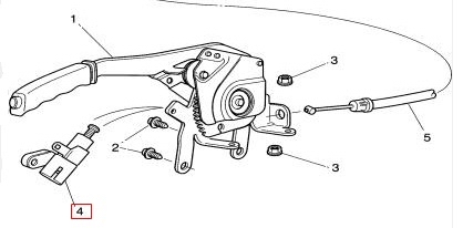

1. Handbrake Warning Light
If your S-Type has the mechanical handbrake, the warning light is triggered by a switch (item 4) attached to the lever assembly:
The P/N is XR813268 but the most likely cause of intermittent operation is that it needs cleaning.
If you have the electronic handbrake, this also has a Park Switch but there's five different P/N's depending on VIN range.

My S type is fully loaded minus the rear blind. I have the folding mirrors which is on a switch on the drivers door, I belive its more likely to be electrical but I will clean up the the mirrors and try to ensure it functions properly.
the handbrake, I think its part 4 thats the issue.. however the bulb is also another great idea, one I took for granted.... so for parts.. I will check the bulb first.. then if that fails I will buy that new unit. because the handbrake functions fine... but doesnt produce a warning light. (saying that when you start the car I am sure its one that lights up??????? before you turn your key????? hmmmmm
