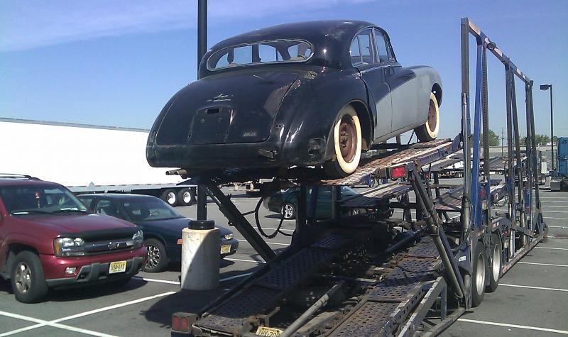

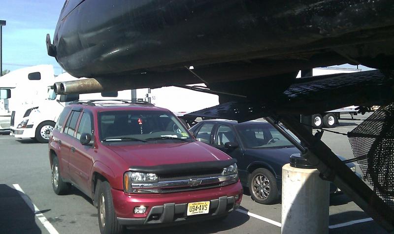

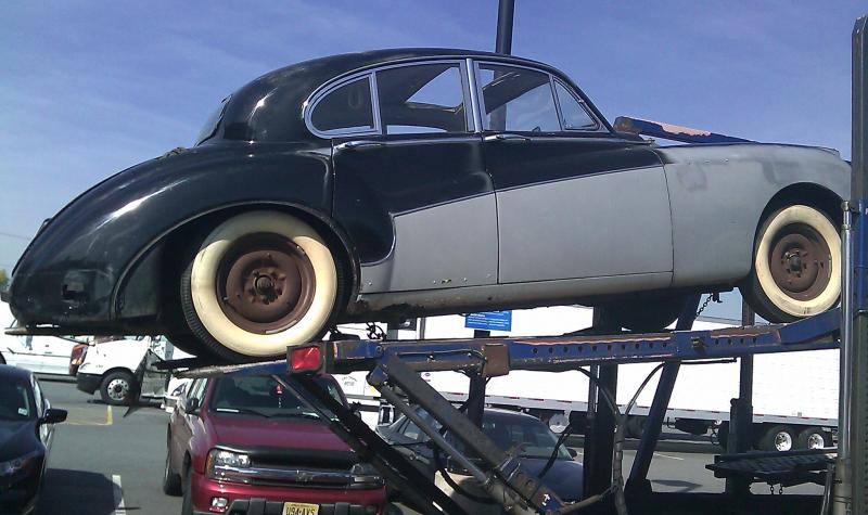

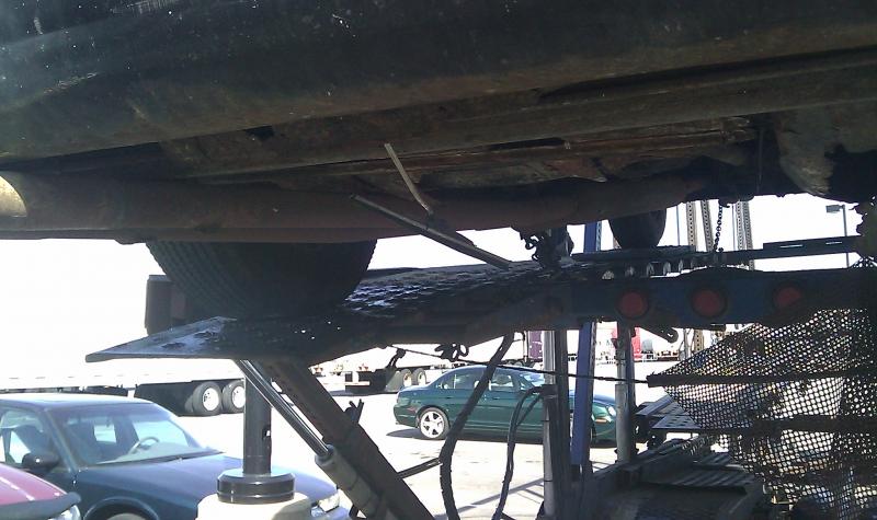

I was at Walmart yesterday and having parked the Jag waaaaaaaaaay in the back I spotted this gem, a Mark IX, on a car carrier. Poor thing ...
But it has the very rare rear wiper option!
