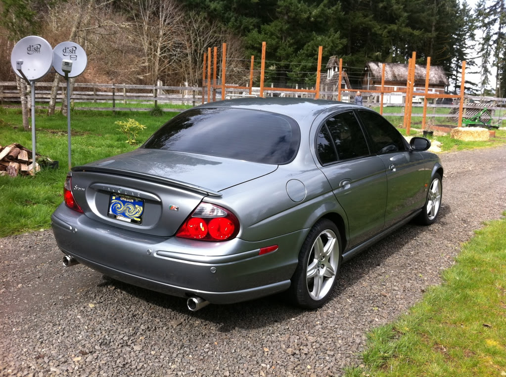

Finally got the tint done today. It has rained 28 of 30 days so she was due for a wash too.
