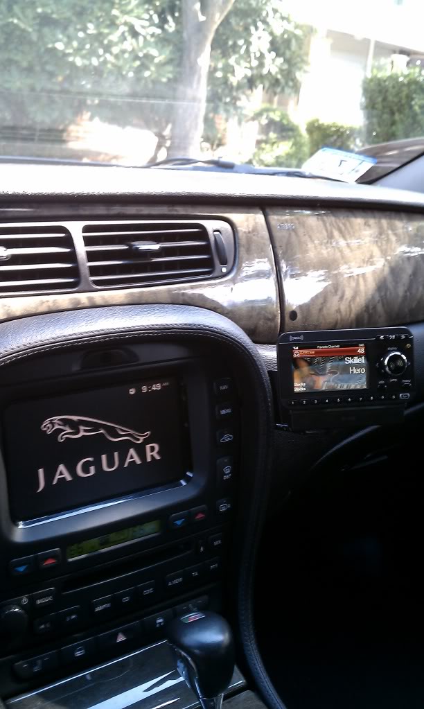

Ok so here's the update, after visiting multiple stores, talking to people and websites, decided to go with XM XpressRCi:
http://shop.xmradio.com/xm/ctl10600/...P_PRODUCT_TILE
Its $169 pretty much everywhere I have looked, full color display, but i got it for $119 through XM's website because I subscribed. This comes with the car kit. I have to order a "2nd car kit" for the wife's Saab, and 2 FM modulators, or whatever they are called.
Spoke with the guy at a respected install place, Boomer Mcloud's, and the guy was extremely helpful. He showed me a mount made specifically for the S type, attaches to the right side of the head unit using an existing bolt (the diagraham showed the bolt to be under the vinyl/leather/stiched surround we have around our head units.
So basically he is going to hardwire the docks, and use the modulator to plug into the antenna input on the back of the unit. I guess these things actually disconnect the FM/AM transmission when the XM unit is ON. Therefore, there shouldnt be ANY interference. He is charging me 2 hrs labor for both cars, so probably a little over a hundred PLUS all the hardware I am purchasing and bringing to him.
Off to search for the rest of the hardware, will keep you updated, and will post pics when it is finally done.

FYI this is what I had to order from Crutchfield for installation on both the Saab and Jag:
220XADV2 XM XADV2 Vehicle Kit XM Dock & Play PowerConnect vehicle kit $49.99 1 $49.99 607FMDA25 FM Direct Adapter Provides a direct connection for a Dock & Play satellite radio to your FM radio $19.99 1 $19.99 607FMDA25 FM Direct Adapter Provides a direct connection for a Dock & Play satellite radio to your FM radio $19.99 1 $19.99 12040VW21 Antenna Adapter Connect an aftermarket antenna cable to the factory radio
Works with a variety of 1986-up European and American vehicles $9.99 1 $9.99 120865618 Universal DIN Tool (Pair) For Factory Radio Removal $4.99 1 $4.99 12040VW12 Antenna Adapter Connect your factory antenna cable to any aftermarket stereo
Works with a variety of 1986-up European and American vehicles $4.99 1 $4.99 000RECVRIG FREE Crutchfield Guide: In-Dash Receiver Installation FREE 1 FREE 000PERIG FREE Crutchfield Guide: Peripherals Installation FREE 1 FREE 000SRADIG Crutchfield Guide: Satellite Radio Car Installation FREE 1 FREE Merchandise SubTotal: $109.94 Standard Shipping $10.99 Order Total: $120.93

A big thanks to Jeff, Leeds and Jason. At first all of this was foreign, and confusing to me, but now I am getting the concept of how these things work and should be installed. I may even just say the heck with it and do the Saab install myself and let them just take car of the Jag. With the reciever, adaptors, mounts etc., its ending up costing a small fortune! However, it will be NICE having a hard wired, Sat radio system with little or no static and not having to deal with those useless FM transmitters.
PS this is the mount made for the SType:
http://a248.e.akamai.net/pix.crutchfield.com/Manuals/042/042JG5203L.PDF

I think I have decided to let them just do the Saab as well. They will charge me around $95, fabricate their own mount and make it hardwired (which i do not know how to do).
I mean, the only permenant mount I could find for that vehicle costs in the $40's anyways so I might as well have them do it right, nice n clean for an extra $50 more than I would be paying just for the mount. I refuse to use the included windshield mount, and the included vent mount wont work because of how the stupid vents are on the Saab. I definately need it hardwired as well, it only has one cig lighter power source and need that for Tom Tom.
That looks real nice on that mount! Great find. Is the tuner as good as it looks? You got XM right? Any bad signal drops? I think I may look at that mount myself.... Move the little control unit up there and put the nice wood ashtray back in...
Do not put in satelitte UNLESS you get the FM Direct Adapter AND hardwire it. I have done several road trips this weekend and there is no static whatsoever. When the unit is on, the adapter literally shuts down the existing FM antenna so no stations will come in potentially causing interference. Shut the unit off, and the regualr FM antenna is activated again. I am impressed with how good it works.
Jeff, the tuner is real sharp, I just wish I had some time to go through the manual and figure out all the options. It records up to 90 minutes and if you like a particular artist or song you can "bookmark it" and when it is playing on another station it comes up on the screen allowing you to go right to that station if you want. The remote comes in handy as well. No signal drops yet (oh except when we were in a 2-3 mile long tunnel), and like I said not even a HINT of interference or static. The tuner is an XM (Delphi) Xpress RCi, so I have XM stations and will be getting the "best of Sirius" packahe for like $3 more month when football season comes around. The mount from Pantovise (I think its called) is cheaper so i would prob order from them, and the installer said that the arm piece that squeezes in between the dash is a little bit skinnier for an easier install.
Panthro - I just realized that, looks like she will either be removed completely or relocated. Good looking badge, so I should be able to find a home for her.
