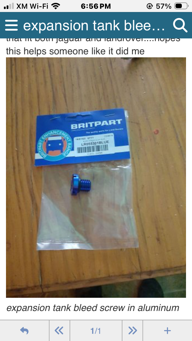

On a side note. There is a metal plug available for the tank bleed. A range rover part. Check my threads i have it there. I have one in tank and one in glovebox

Here it is

Thanks for posting that!
It looks just like the one I replaced on my 2014 XJR heater bleed! I bet they are they are same. I installed an after market one as I did not know about those LR part numbers.
It sure looks to be the same and I had no idea that plug was used on so many JLR's!
Here is an ad from Euro AMP.

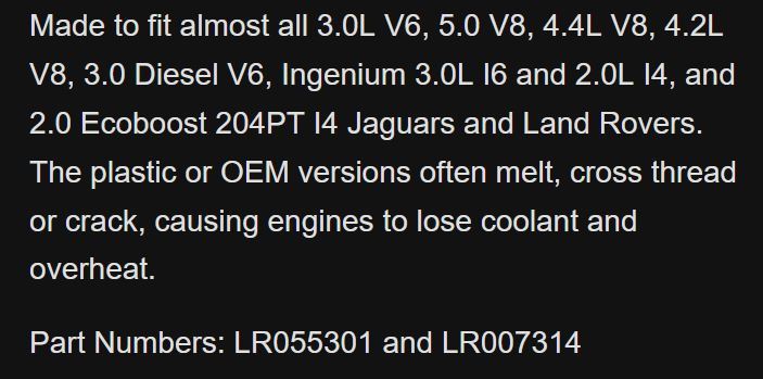

Brass Coolant Bleed Screw

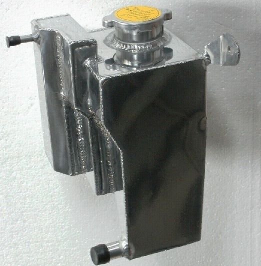

Here is an after market Aluminum version. Only for the 2000-2002 models. A little expensive compare to the plastic ones but still under $200 for a lifetime tank is not bad. I went thru 3 of the plastic versions on my old 2005 S-Type R. So money wise it could work out if your a long time owner.
Aluminum Upper Tank
Surprisingly here is one for the later S-Type, XF, XJ8! Cheaper too and of course it's from China as well.
S-Type,XF and XJ8 Aluminum Tank
For $120 I would be VERY tempted to get one if I still had the old STR. That's not a bad price for a fully heliarced Al. tank.
Does anyone have any experience with either tank? I have not seen any postings about them good or bad?

not up close. I was thinking of one for my str but noticed the bottom hose connection is going to be clamped and not for the push on oem hose and clip so i passed

the lower hose being a proper hose clamp rather than the crappy plastic clips sells it for me .... I can buy hose by the meter and use some brass fittings and throw those crappy molded hoses away
