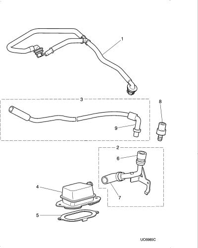

I just bought my IMT rings for $5 and change. I also picked up the elbow for the vacuum leak. They have two different ones, one they think it is for sure and the other one they said to replace while everything is apart. (number 9 + 7).
