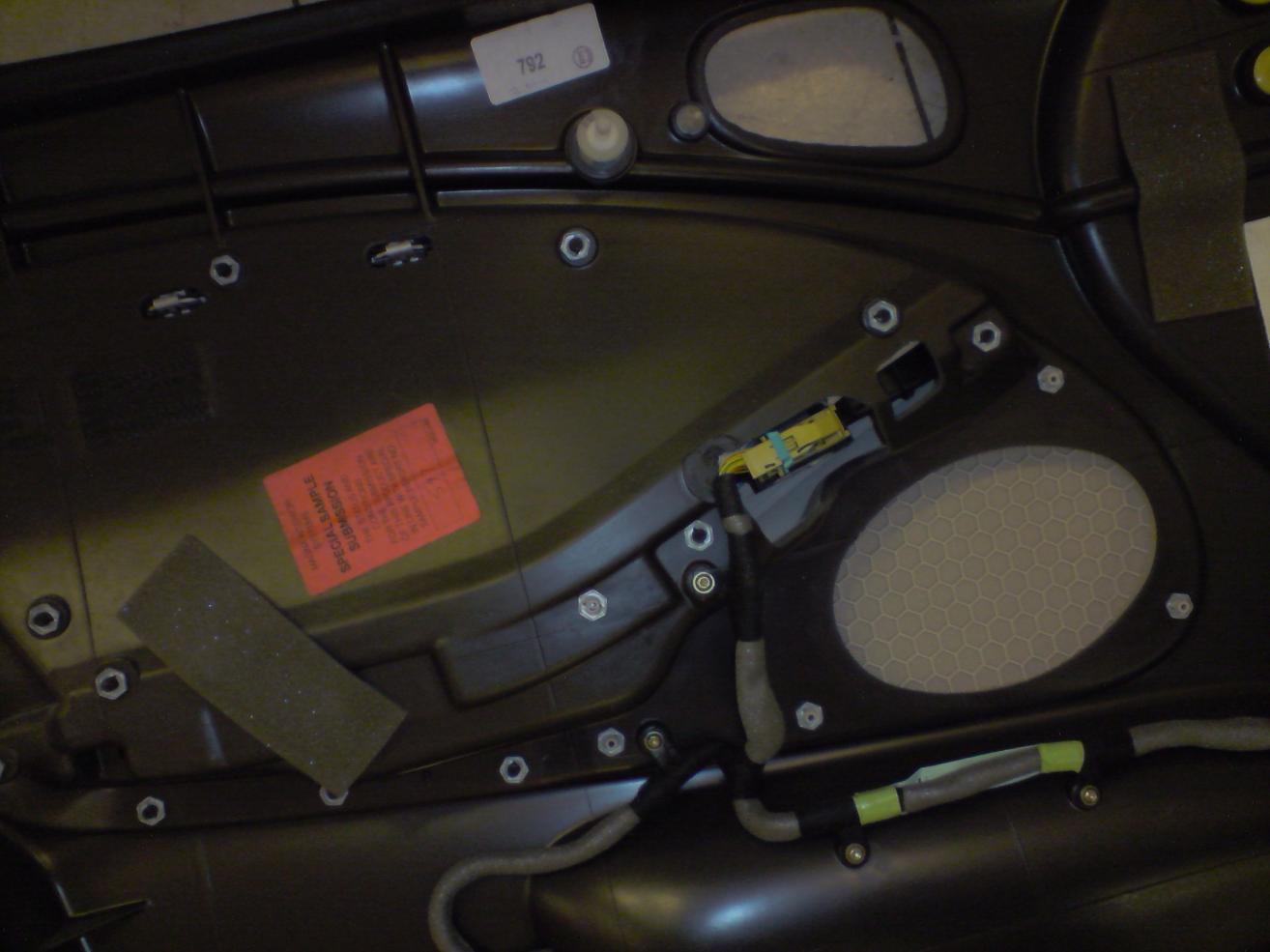

Whilst I was probing I thought I would check out the standard speaker set up.
It was just that......standard! The size is restrictive @5x7".

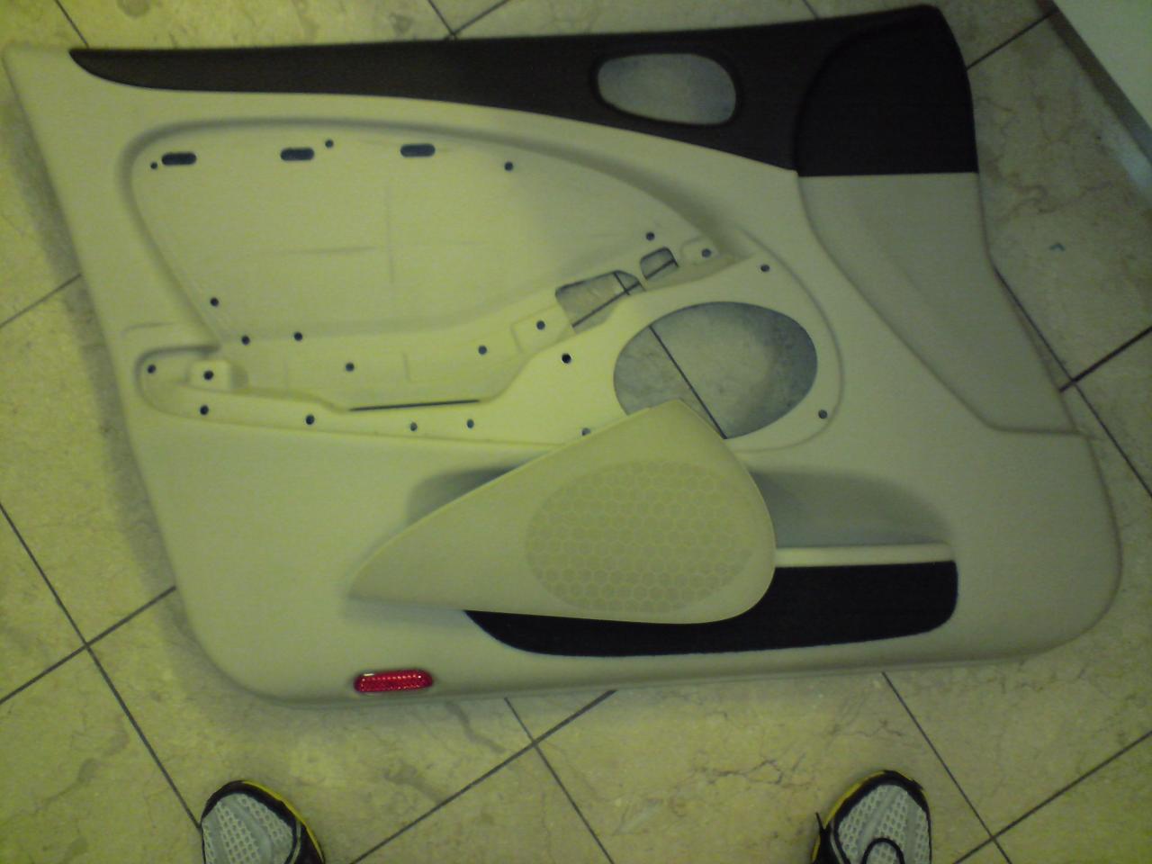

I had a good 6.5" setup with splits lying round that I thought I might make fit.
A lot of work to manufacture an adaptor plate and use existing 2 screw holes where the speakers are to fit.

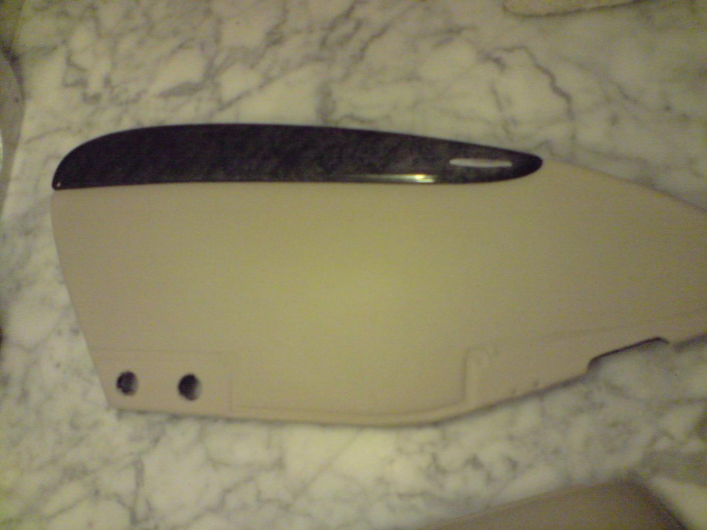

I intend to cut only the leather on the door trim for the tweeters as it is easily and cheaply replaceable, and not batstardise the door trim.
I have to work out where to fit/secure the crossover.
Notes/Questions:
The door is well engineered to create good bass and needs to be as airtight as possible when reinstalling all fittings or plastic covers. So fresh glue/mastic.
Any replacement speakers fitted need to seal well on any plates that are may be used. So gasket up.

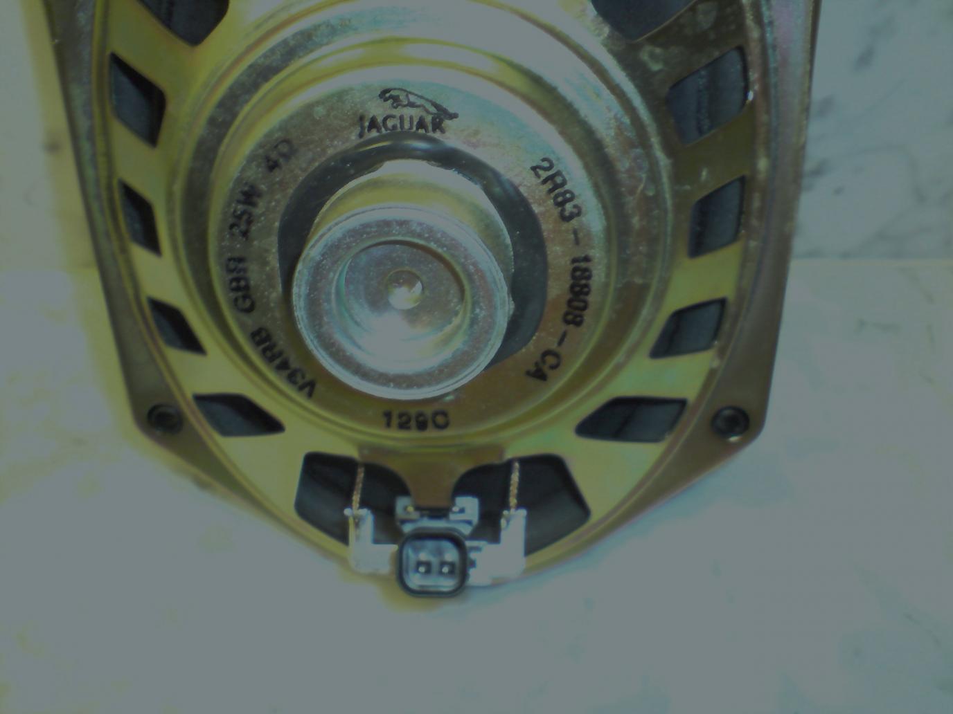

Need help on the polarity of standard setup/loom!!!
