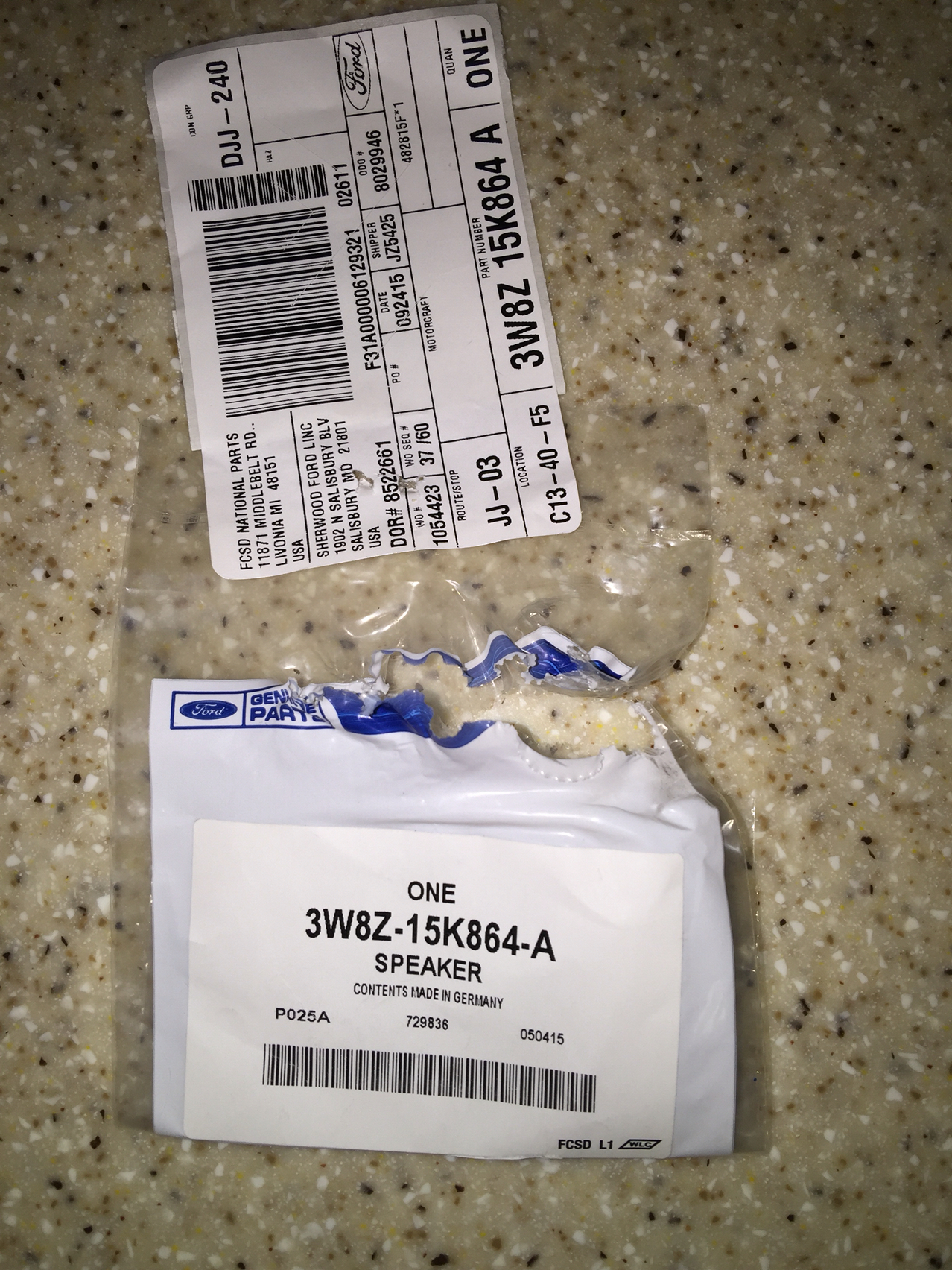

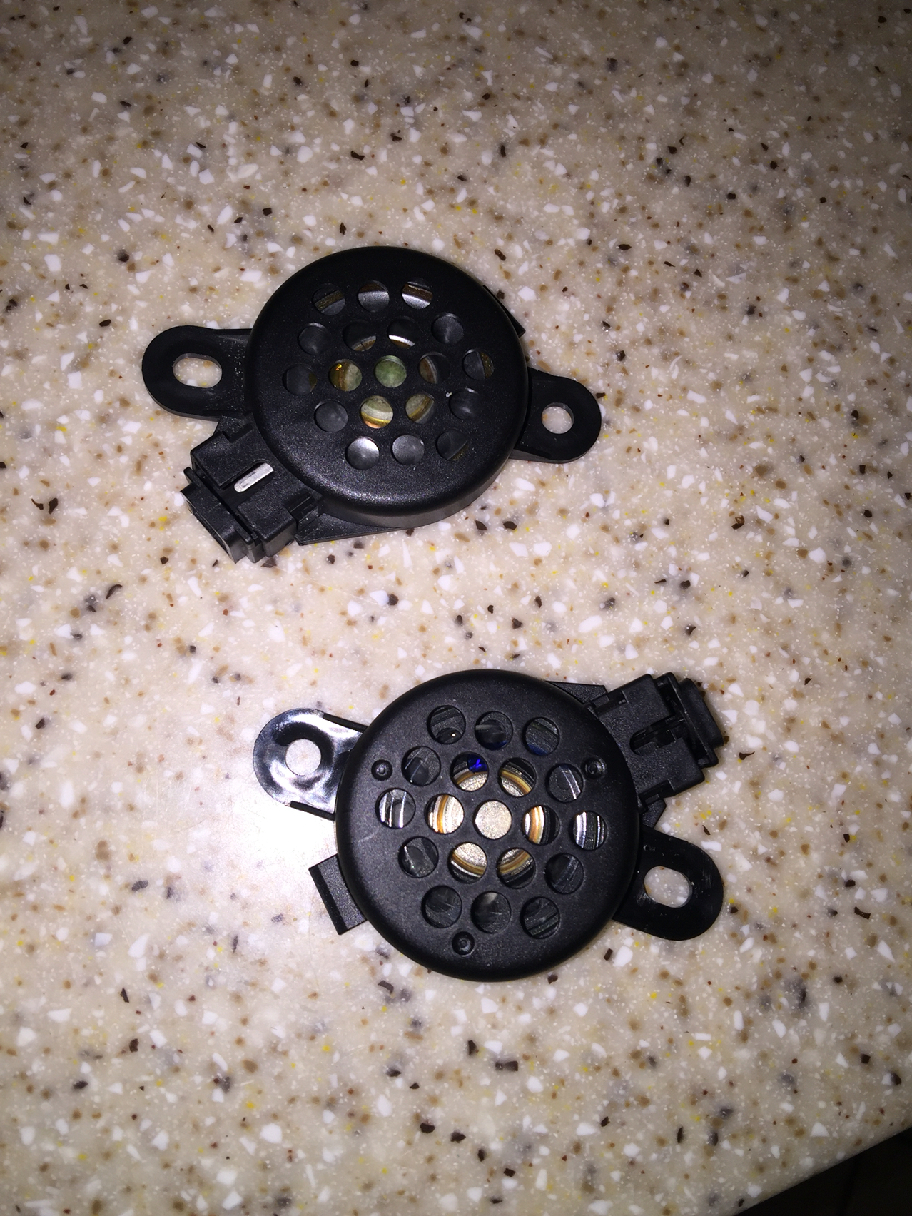

A couple of photos. Hard to see, but the new one does say FoMoCo.
Thanks again
