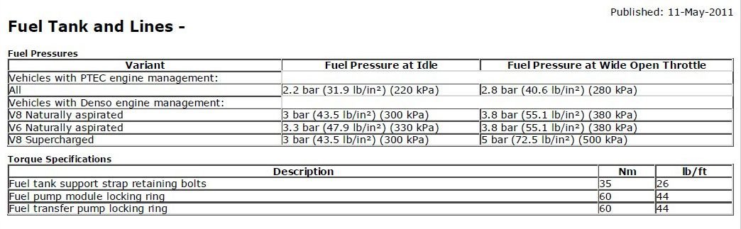

Check to see if there is fuel pressure at the schraeder valve on the engine above Bank 2. If not, fuel pump may be failing or seized.
Here are the fuel system specifications:
