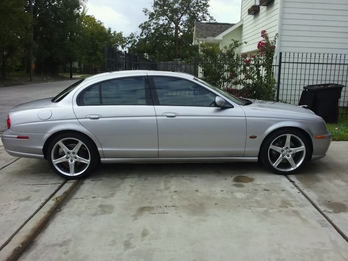

Hello Everyone,
I wanted to ask your opinion as to the source of this problem. For some time now, my steering wheel shakes when driving around 30-50mph. It goes away when driving on the freeway 60-70mph.
Within the last six months I have changed the Front upper control arms, front Steering knuckles, Front Sway bar bushings. I am in the process of slowly buying rear suspension parts as they are VERY deteriorated. ( Rear Upper control arms, Bushings on rear lower arms.
I replaced my 17 inch wheels with 19's yesterday. The shaking is much more evident now. What do you guys think?
17's
19's

Neither set of wheels looks factory...? If they are both aftermarket make sure you have hub centric rings.

The chrome 17" wheels were factory. 10 spoke OEMs
