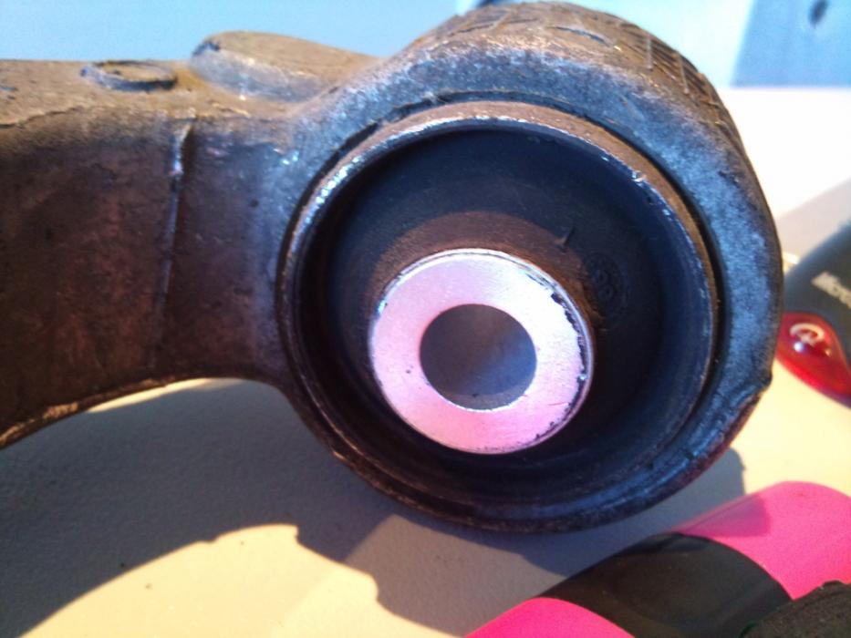

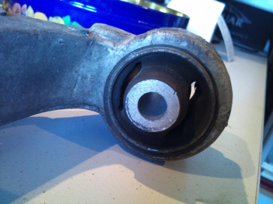

Default Rear Lower Control Arm Bushes Available
My local wrecker/breaker here in Melbourne has been doing lots of research on the 'cross axis' bushes only (ball joint type) in the rear arms. They tell me they have found a bush that is a suitable replacement. And have trialled and run a car with satisfactory results. There are other firms of course that have the ability to to this also as we know by reading the UK thread as mentioned by Clubairth1.
The Melbourne wrecker/firm here was honest and mentioned that they were dealing with a large group that speacialises in bushes and are sourcing then out of Taiwan. I have had a good look at them and they don't feel too bad IMHO. I don't think this quality could come out of China yet. I don't know what country the UK suppliers get theirs from. And the originals on my car only lasted 24,000miles (39,000km).
The two similar looking 'cross axis' bushes are in fact different widths from factory so a washer is required as well when mounting the arm to the wheel knuckle side, that is supplied. I will provide more photos soon of the work they have done when mine are pressed in. The narrower 'cross axis' bush fits on the subframe side along with the other adjacent rubber bush.
This other (larger of the three) rubber bush is is not currently available and is still causing us all much grief as you need to buy the whole arm. I am not even sure if you could press that larger bush in or out?
Also one thing I recently discovered about this larger bush; It differs in the Super Charged cars. It's the heavier duty looking plain rubber style bush and not the hydrabush style, to take the extra power. You would assume it would have less comfort but last longer.
Attached Thumbnails STR Lower Control Arm Bushing-v8.jpg   STR Lower Control Arm Bushing-v8casting.jpg   STR Lower Control Arm Bushing-scv8.jpg   STR Lower Control Arm Bushing-sccasting.jpg
