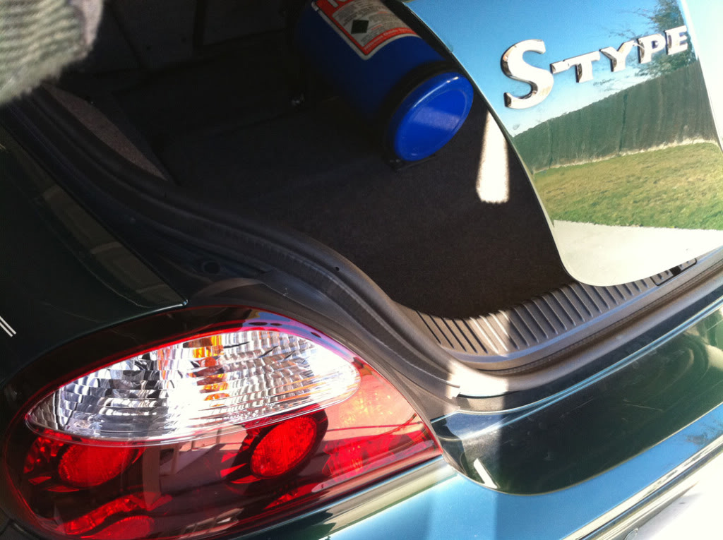

Old Dec 5, 2010 | 04:03 PM
nixx's Avatar
Joined: Oct 2010
Posts: 74
Likes: 13
From: DFW, Texas
huh?
