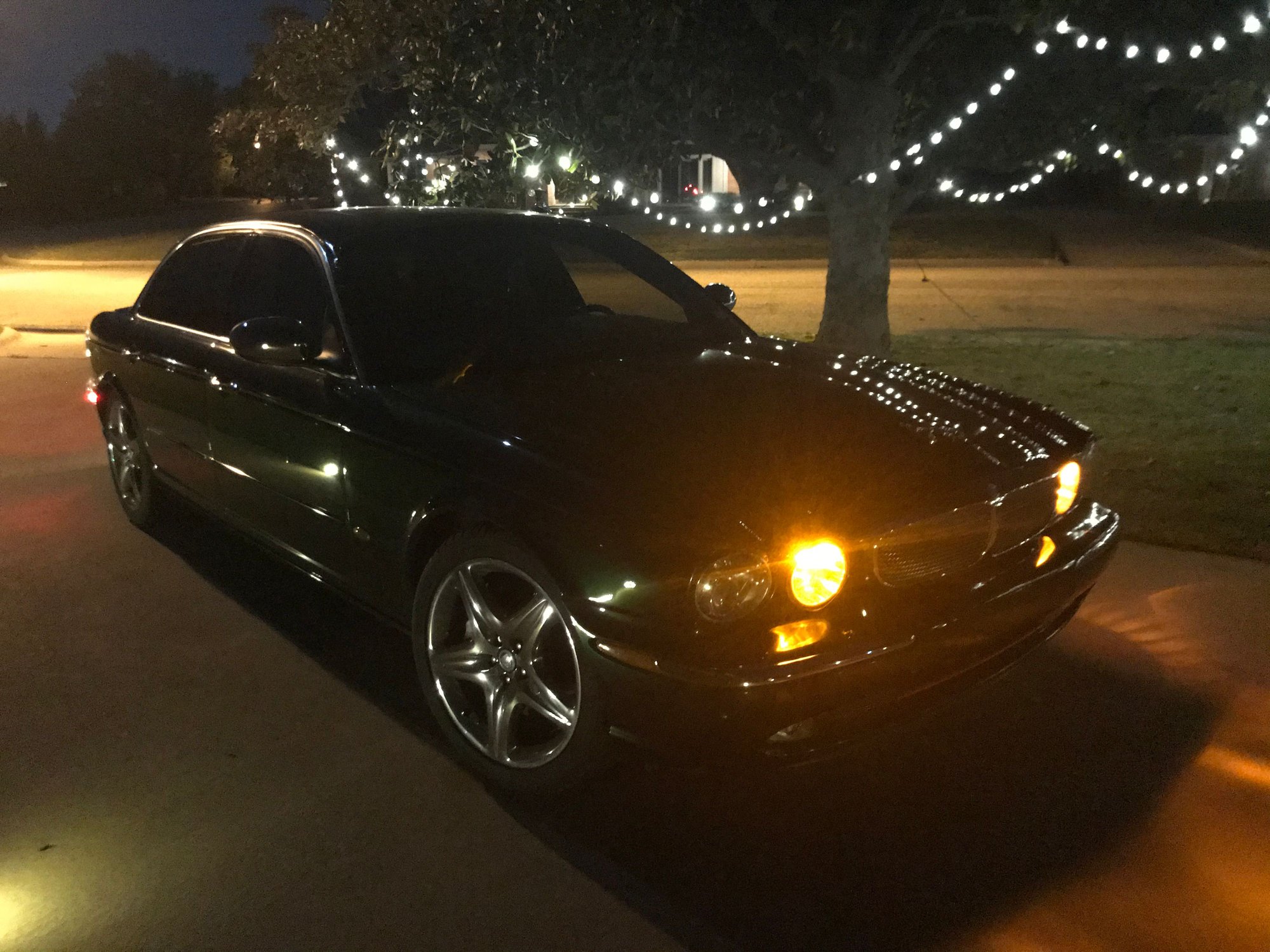

Help me out here... I used to have an s type and there are definitely things that I miss about it. Now that I have an 05 Super8 ( SAJWA82B15TG39292 ) I have gotten really spoiled with some of the extras that do not seem to be on the s type r (str). To save me a bit of time, and the fact that I am a bit overwhelmed with the copious amount of info on the site, Can you tell me what the super8 has that can be put on an STR, without being a seasoned mechanic. Also, what cant be added(without considerable modification)? What isn't possible at all? What is possible, but too crazy expensive? My lady love really is into the extras the S8 has in the back seat.
