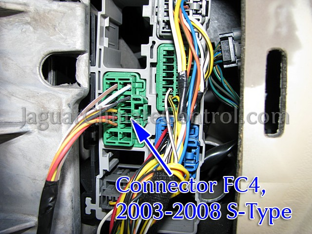

For some reason I was thinking the there was a connector FC4 thats I. The little side panel on the left side of the instrument panel that has those dccv wires. Ill pull out the ol schematic and verify
Old Jun 19, 2023 | 07:37 PM
kr98664's Avatar
Posts: 4,928
Likes: 2,324
From: Oregon
Originally Posted by Aarcuda
For some reason I was thinking the there was a connector FC4 that's in little side panel on the left side of the instrument panel that has those dccv wires...
You can see FC4 near the bottom of this page:
http://jaguarclimatecontrol.com/diagnose
Image from JaguarClimateControl,com
