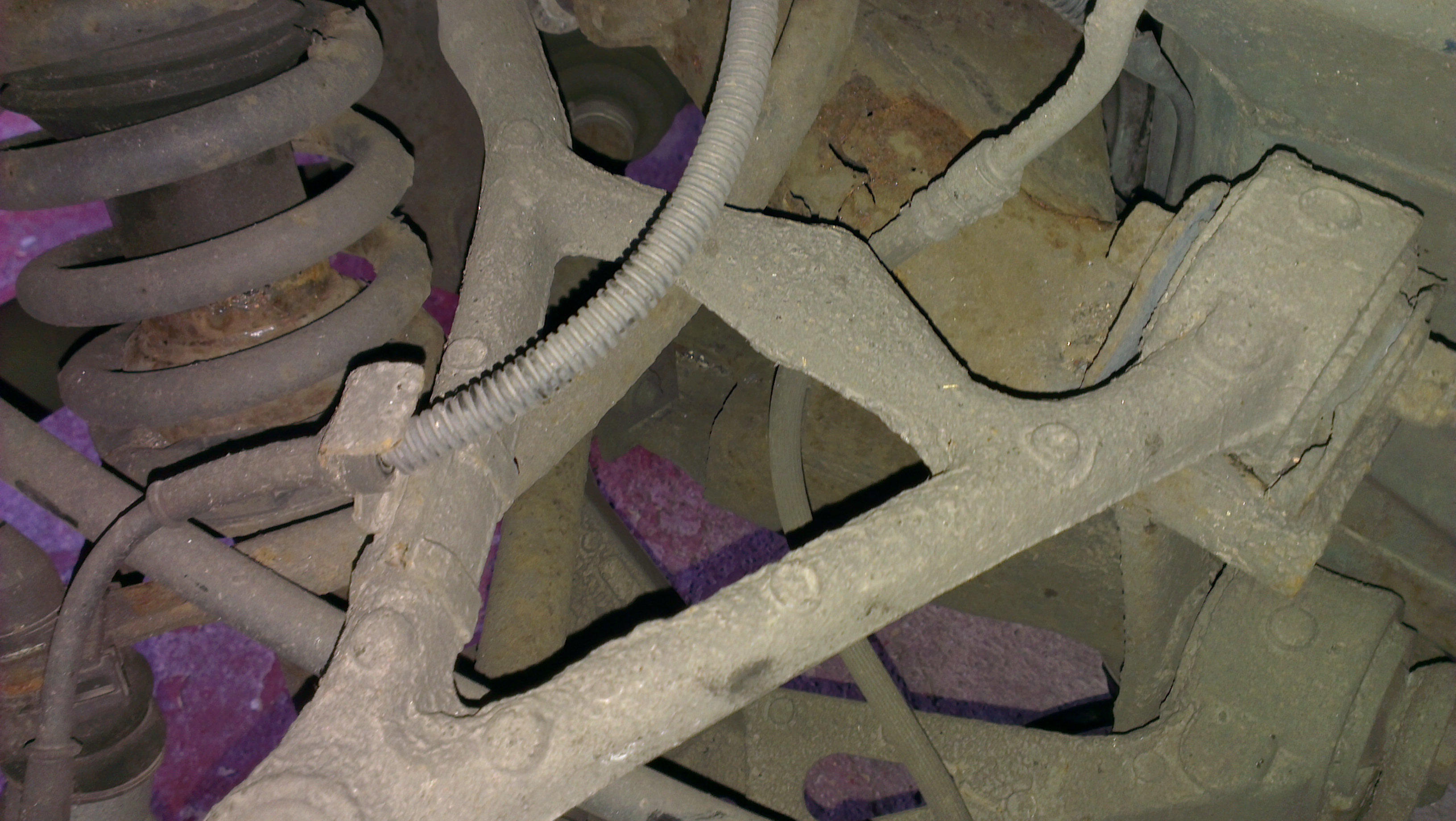

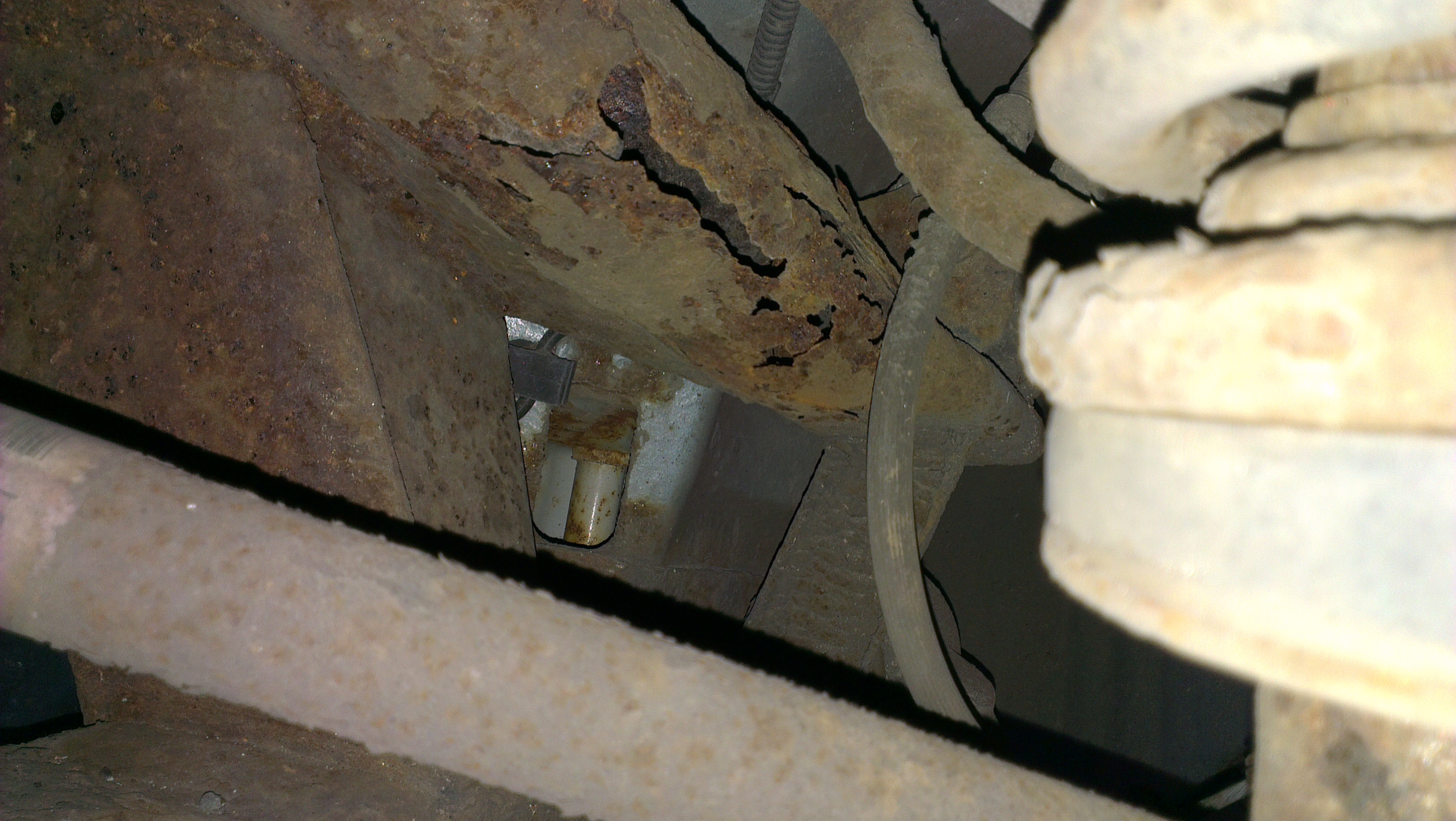

As I have mentioned in a few posts, I am currently working my through my recent acquisition, and today I had the rear wheels off to check out the brakes/Discs and suspension components. They looked OK, but to my horror, I saw that the subframe is completely rotted through in places. I have seen some rusty subframes in the past on cars, but it was always surface rust which looked bad but didn't affect the integrity of the car.
This looks really bad.(see photos). I have done a search through the forum and on the web, and it seems I'm not the only one to have this problem. However, I can't find anywhere, a post say that someone did their own DIY change of the rear subframe. I can't afford to take the car to a garage, so if its not possible for me to do this myself on the drive, the car is probably a write off.
Assuming I could get hold of a decent replacement subframe, is it possible to do this as a DIY job? I'm not a professional mechanic, but I have done all sorts of work on my other two cars, but never a subframe removal and refit.
Has anyone on here done it? I'm clutching at straws now, I had high hopes for this car, she looks really good everywhere else, so I'm a bit gutted by this find.

Take a look here Suspension Rebuild MY 2000 - www.jec.org.uk

Having looked at Norri's link, I would say buy a decent used sub-frame and refurbish it before swapping over. But even so that still leaves some work on the cars bodywork.

Having slept on it overnight, I have decided that the car is going to go. I don't give up on things that easily, but there are a number of circumstances at play which means I'm just not going to be able to put the time, effort and money into such a big job.
I only got the car to take it off my son's hands to help him out (gave him what he paid for it), but I was really hoping I could get the old girl back to some former glory. The only things that would stop that happening were a major engine fault, failed auto box, or ......... major subframe rot. Everything else is easily fixable.
