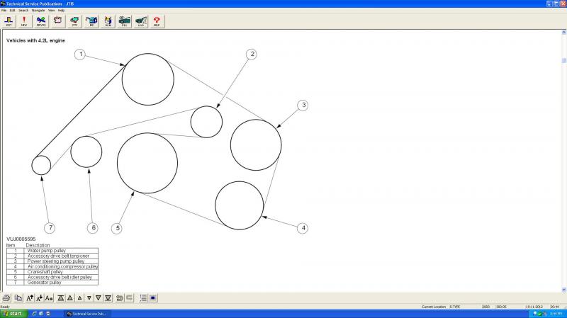

So while I'm down... I'm browsing looking for a diagram of the serpentine routing. IO can't find one. I tried to follow the procedure to download / Install the JTIS, but it ain't workin' for me.
Can somebody please point me to a simple diagram of the belt routing?

A few diagrams will help!
Attached Thumbnails Supercharged Squirrels in my '03 STR-4.2l-belt-routing.jpg   Supercharged Squirrels in my '03 STR-sc-belt-routing.jpg

Thank you!

Those and many many more are in the free downloads on the site... go get 'em!
