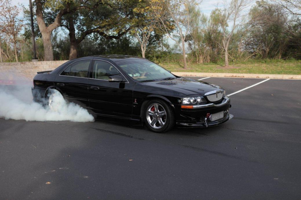

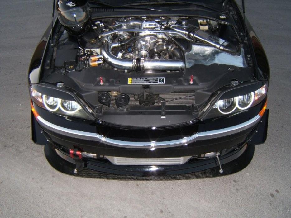

Again the rear mount turbo (STS) has been done on the Lincoln LS also. Everyone who has installed this on a Lincoln LS has removed it. A very interesting idea and allows you to turbocharge cars that have no engine compartment space.
Be careful with EuroTek!! They have many HP and Torque numbers on their website and zero dyno charts for the STR. Not a great way to run a tuning business!! The black box style of tuning is very expensive and not that great. You really need someone who can put the STR on the dyno and tune it there. I can't find ANYBODY who can do this yet??? If you do let me know!!!
Interesting to note is the 3.9L Lincoln LS that has been supercharged and dyno tuned puts down 408 HP at the wheels!! It also runs a documented 12.831 1/4 mile @123 mph!!! Top speed 153 mph. Also the stock transmission has held up for the 2 1/2 years and 14K miles the guy has run this. He also autocrosses the car heavily and does top speed contests. So the car is very well sorted out.
This really shows how much Jaguar detuned the STR. Bigger engine 4.2L .vs. 3.9L. Also the Jaguar has a 6 speed instead of a 5 speed Automatic. Plus the LS is only running a M90 instead of the improved Gen V M112 super charger!!! The LS does have a LSD and the ability to run different rear gear sets and above all the ability to TUNE the combination!!! The STR hold much promise when you look at this!!!
Attached picture of the supercharged LS.
https://www.jaguarforums.com/forum/a...1&d=1274793052
Attached Thumbnails Supercharging a 4.0-supercharged-ls.jpg   Supercharging a 4.0-supercharged-ls1.jpg
