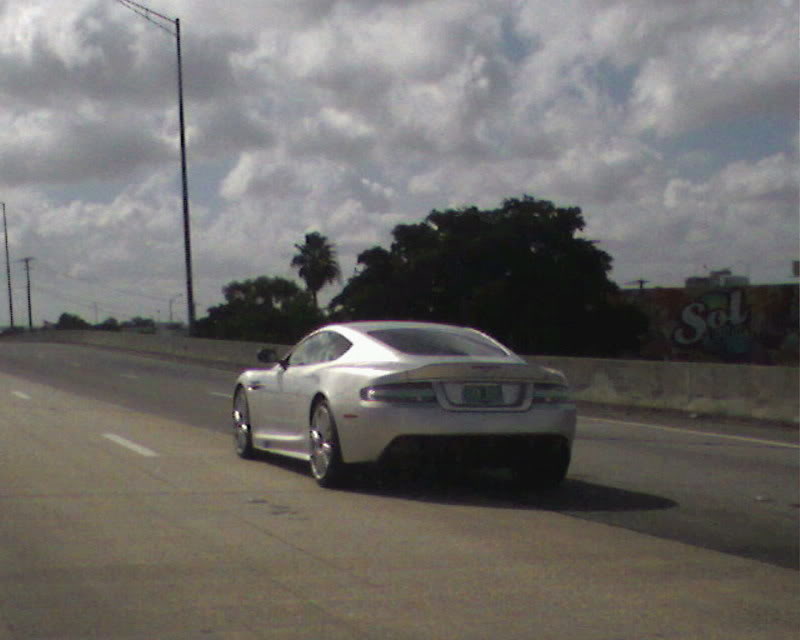

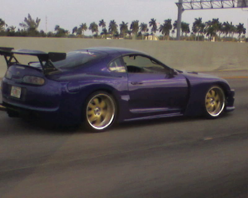

So I guess the answer to that question would be, there are not very many fast cars on this forum so no one talks about racing.. However, I get in at least 2 good race either coming from or driving to Ft. Lauderdale every day.. Just last week I got into it with a DBS and two weeks ago me and this Supra got into it and took our cars up to 150 on I-95.. The supra had carbon fiber: doors, trunk, bumpers, door panels, 13" wide volks, and a turbo that sounded meaner than my T76.. Needless to say he beat me every time, he gave me the go then reeled me in bad, but it was a hell of a lot of fun!
The DBS was something else.. not nearly as fast as the supra, but it was amazing.. I see DB9s all the time, but never any S's... I got next to this guy and dropped it into neutral and gave him a rev, we honked it out and he let me take if, he pulled on me and I topped my car out trying to catch back up... We definitely need a kill story section, or an R section..
this forum is full of boring law abiding citizens I guess and they don't like street racing.. So I guess the answer to that question would be, there are not very many fast cars on this forum so no one talks about racing.. However, I get in at least 2 good race either coming from or driving to Ft. Lauderdale every day.. Just last week I got into it with a DBS and two weeks ago me and this Supra got into it and took our cars up to 150 on I-95.. The supra had carbon fiber: doors, trunk, bumpers, door panels, 13" wide volks, and a turbo that sounded meaner than my T76.. Needless to say he beat me every time, he gave me the go then reeled me in bad, but it was a hell of a lot of fun!
