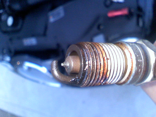

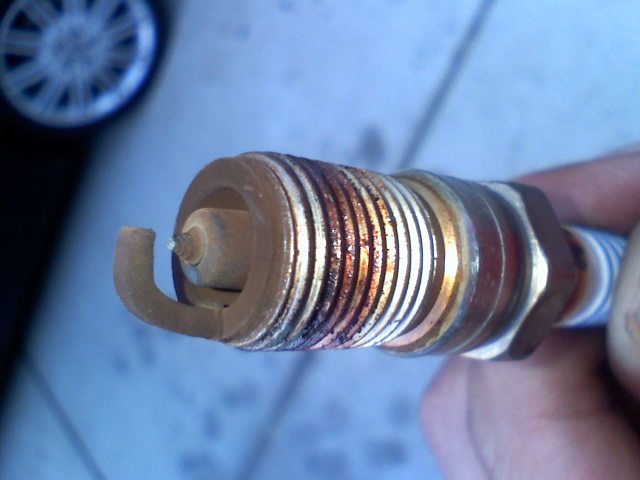

I decided to take a look at the spark plugs and found a big surprise. the spark plugs where so damn bad they are completly covered in what looks almost like rust or some thing had like a brownish dark burgandy color. all plugs are like this but one seems like it had oil on it the whole tip is covered the center electrode, every thing Im pretty sure that the check engine light would start throwing missfiring codes but for some reason it hasn't. the same thing with the oil pressure, the light didn't pop up when I was running on 4 quarts of oil Wich has me thinking some thing is wrong with the computer maybe? All dash lights do come on when the car is turned on.
The coloration on the center insulator is pretty normal.
But, the gaps are HUGE -- unless it is an optical illusion.
suggestion:
1. clean out the sparkplug wells
2. install new properly gapped plugs
Then, if the car can survive a longer drive, warm it up well to evaporate any condensation out of the exhaust system and see if the white smoke is still present. If it is, it could be a head gasket problem.
suggestion:
they look huge in the pic but there gapped at the recomended size. I'm trying to change the other three but cant get the intake manifold off due to two hard plastic pipes: one behind the intake and another just below the throttle body. How can I remove them?

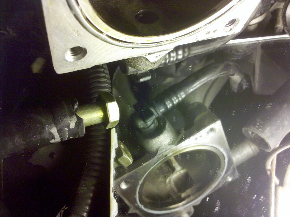

JoycesJag is the expert on that one. (or is that the X?). There is probably a stickied thread at the top or in the FAQ.
"quick-connect" vacuum lines that would be more accurately called "bitter-ex-wife-to-disconnect" fittings!!!
You have to use a very small screw-driver or similar object (I had success with a nail-set) to push inward on the outer plastic ring where the tube penetrates the aluminum. You might think it is extra-difficult because you can hardly see it or access it....but that's only the half of it....it's still a B even if you get it out on the bench with good light and good access.
Still, I do have to admit that they reconnect quickly and easily.....
The one at the back:
This part stays with the manifold when the tube uncouples
And in the front:
Sorry, didn't take a de-coupled pic. (In case it is confusing, we are looking at a mirror held under the vacuum fitting, with the throttle body removed for clarity)
I see what looks like a ring around the pipe that connects in to the intake, am I supposed to compress the ring from two sides or pry it out the intake with a flat head screw driver?

Yes, push in on the annular ring. If you can do it from two sides at once, I'm sure that is goodness, but unless you are 3-handed, may be difficult..you need to pull out on the tube when you hear it "click" ...can't remember if pushing in on tube helps or not. Maybe Rick will weigh-in soon...I think he knows....I even tried the little a/c - fuel line quick-connect tools on it to no avail. As best I recall, pulling out on the tube whilst trying to press the ring inward is kinda like trying to lift the chair you are sitting in....

dang that was a piece of cake the whole time I thought It was never gonna come off but I just pushed and pulled. Thanks for the advice

Rust looking deposits are not from water...
Odds are they are covered with this and ash..Tells me someone ran cheap fuel and tried to compensate by dumping a "bunch of snake oil" in the gas tank.
MMT Fouled
APPEARANCE: Spark plugs fouled by MMT (Methycyclopentadienyl Maganese Tricarbonyl) have reddish, rusty appearance on the insulator and side electrode.
CAUSE: MMT is an anti-knock additive in gasoline used to replace lead. During the combustion process, the MMT leaves a reddish deposit on the insulator and side electrode. RECOMMENDATION: No engine malfunction is indicated and the deposits will not affect plug performance any more than lead deposits (see Ash Deposits). MMT fouled plugs can be cleaned, regapped and reinstalled.
