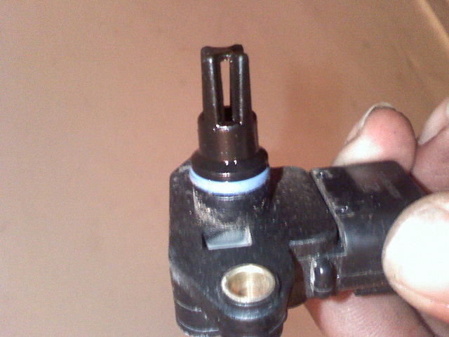

Sorry that I am late to the party, but Zane has you hooked up.
About the MAP Sensor
that looks fine, nothing missing.
