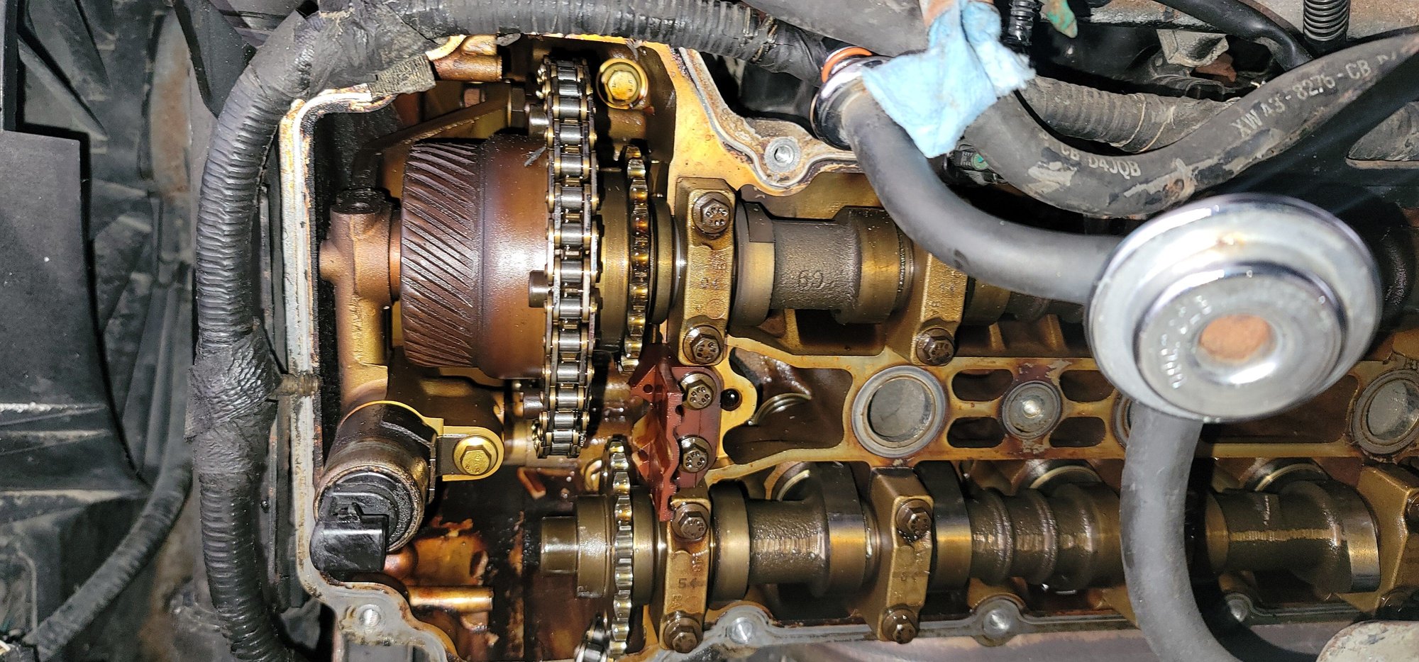

Hey guys so I got a good amount of work done on the jag today. Still awaiting my alignment tool and some more goodies. But I was looking around for a trans cooler and I don't think I'm seeing one. Does the 2000 stype 4.0 have a trans cooler? If not I want to add a large one right away if this is possible. So my driver side small chain snapped upon start up the other day and only ran for 2 sec before I turned off. Today I took a bore scoope camera down the cylinders and there's no signs on impact with the valves. Thank God! Here's a little puc of the carnage.
