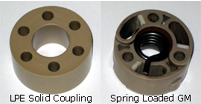

That's not what the TSB is for. The TSB is for a noise when cold and first started.
I think you are hearing the SC coupler rattling. You can replace it yourself but you might consider having the blower gone thru with new bearings and checking the rotor clearance.
The Eaton is very durable and you can most likely keep driving it. The factory coupler has springs to help with the noise. The aftermarket usually will replace the coupler with a solid piece for better durability.
See the difference;

Does this fit the S/C coupler idea as described by Tbird6 above? I am not even sure what the coupler does (I imagine it couples ) or where it is located. Based on the photo, I'd imagine it must be exterior to the S/C, maybe crank-mounted and turning the drive-pulley?

The more I read your description the less it sounds like the coupler??
Sorry about that!
If you are interested this set of pictures shows where the coupler is:
How to replace an Eaton Supercharger Coupler : SuperchargersOnline, Worlds largest Supercharger Resource. Get Serious About Power
