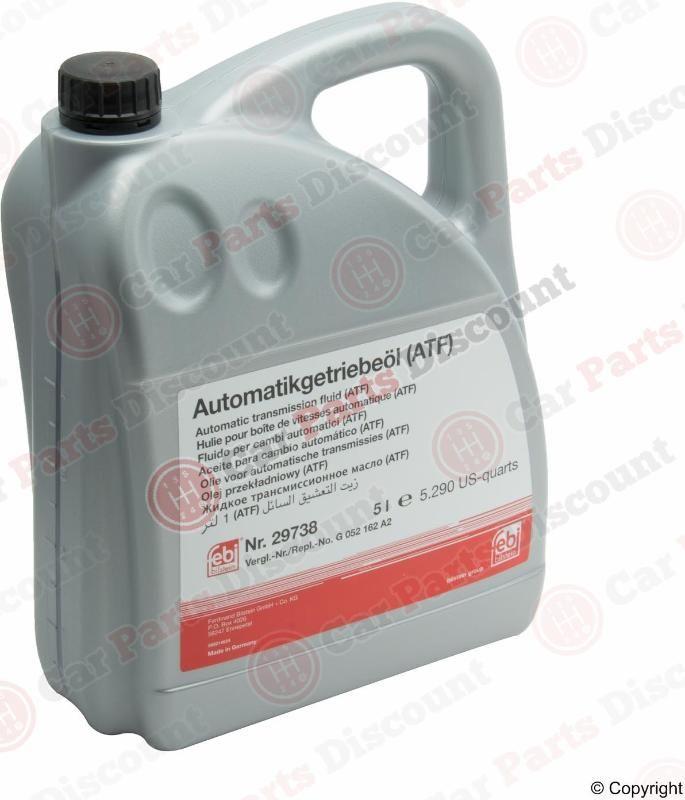

I found those , which one is better ?

so which one of those oils that I shared below, you think will be perfect for my tranny without the need to add an additive in order to get better shifting ?
Two of us have already answered this question.
