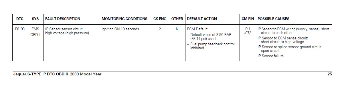

As a newbie, you won't be able to download the DTC (Diagnostric Trouble Code) PDF so here is the extract for P0193:
P1111 is not an error code - it's a status indicating all onboard monitoring test have been completed.
