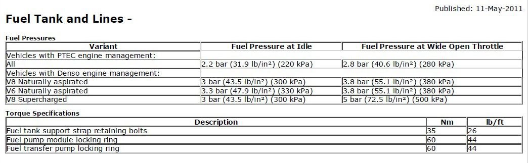

Check the fuel pressure with a gauge. It could be a partially blocked fuel filter or a failing fuel pump.
Here are the fuel system specifications:
