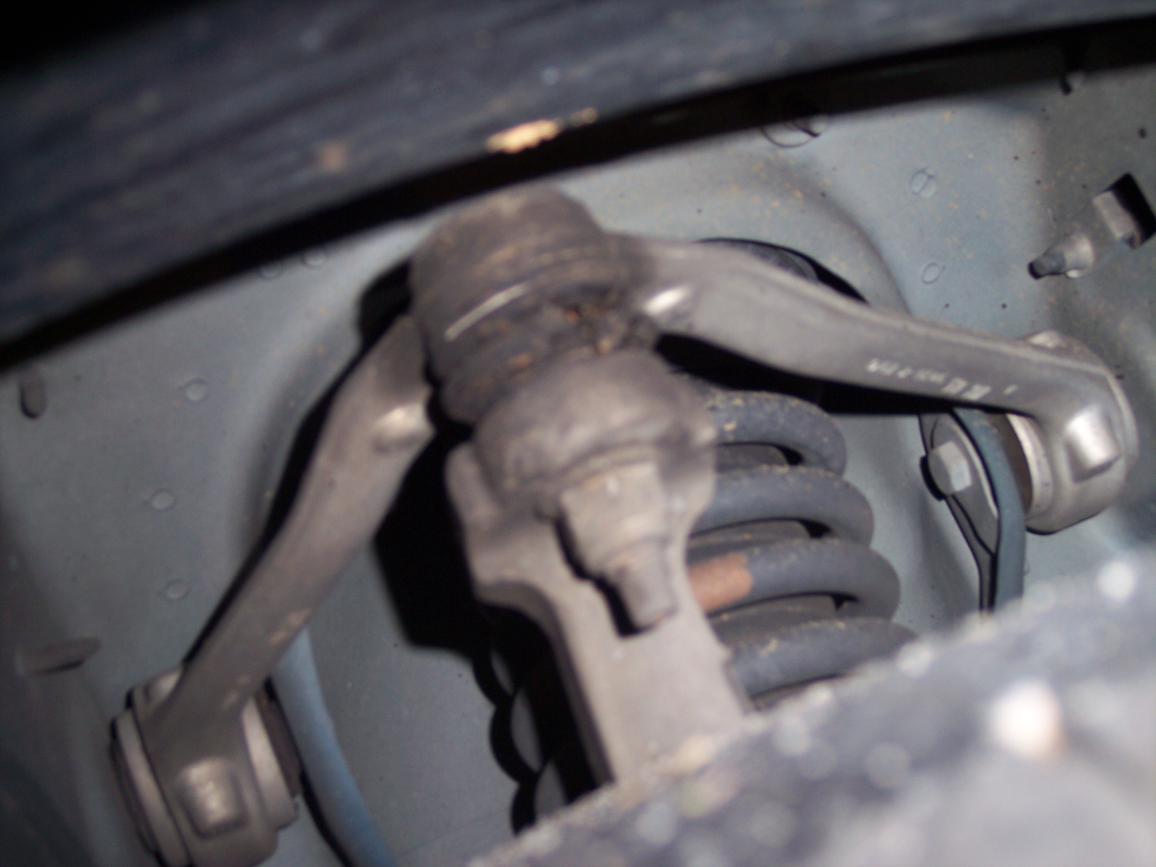

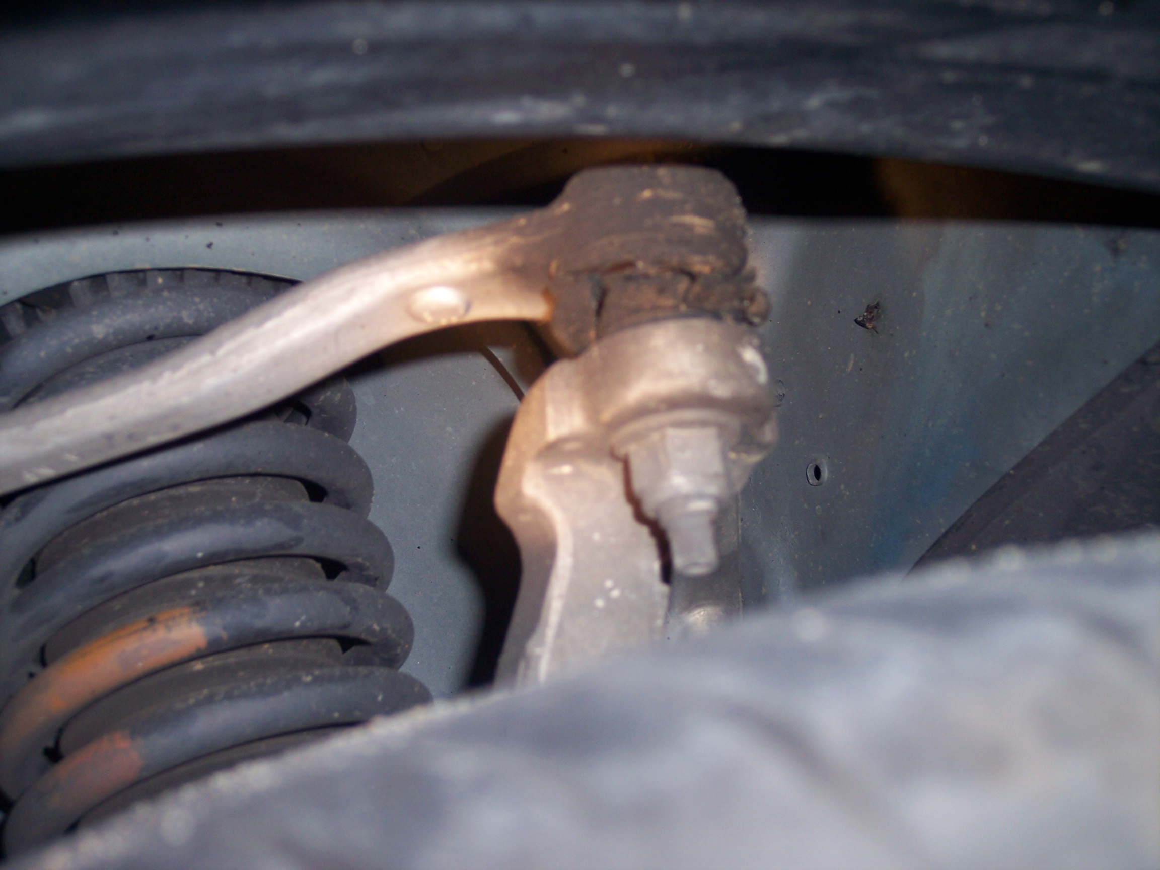

Old Nov 20, 2013 | 10:59 AM
  #38
cats4.2's Avatar
Joined: Oct 2010
Posts: 85
Likes: 14
From: Mississippi
my old parts look like this...
the same as yours?
Attached Thumbnails Upper Wishbone -- how to replace?-jag-passenger-side-upper.jpg   Upper Wishbone -- how to replace?-jag-driver-side-upper.jpg
Old Nov 20, 2013 | 01:18 PM
  #39
OldMike's Avatar
Joined: Mar 2012
Posts: 1,531
Likes: 204
That's pretty much how mine look!
