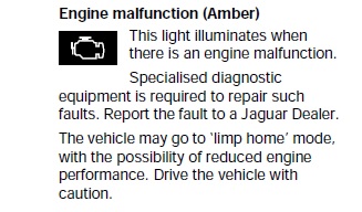

Welcome to the forum John,
You will find the following additional information in the Owner's Handbook:
Not essential to use a Jaguar Dealer but necessary to use a code reader or scantool to determine the cause of the MIL.

Don't be too rough on whoever wrote the handbook. As a former tech writer myself, the marketing department probably had the greatest degree of input.
Handbook shortcomings aside, the light is actually a very useful indicator. If illuminated steadily, it means you've got an issue that needs attention soon, but isn't crisis level yet.
If the light is flashing, that means you've got a critical fault causing overheat damage to the catalytic converters, as previously mentioned. Stop as soon as you safely can. If the light stops flashing at lower speeds, you're generally safe to slowly drive home, but don't ignore the flashing light.
You will need an OBD II code reader, or preferably a scanner, to read the fault codes that have been stored. While an OBD II diagnostic device is pretty much required for working on any newer car (plenty of low cost options, just ask if you'd like more details), many auto parts stores will read them for free. Make sure you get the actual code (P0301, for example) instead of the generic description. Report back with your fault codes and I'm sure we can walk you through a good fix.
