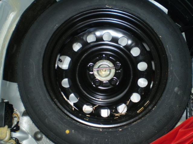

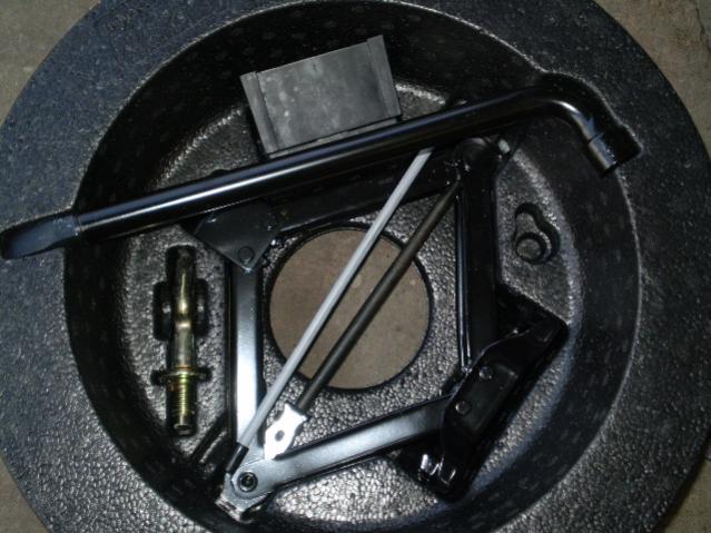

OK, I have the same year as Jon.... I just got done mounting my spare and it is fine. So, Jon, while I understand your temptation to blame Jaguar, they are not at fault as far as I can see. The included equipment work just fine. I was able to hand tighten my spare to the point of "snug". So, somewhere along the line the equipment included with your car may have gotten switched to the wrong parts. To that end I have taken pictures of all the stuff that came with mine. I do see that the mating surface of the spare does take a conical nut. I also see that the end surface of my lugs are conical and fit the seat surface of the spare. Also, there are actually two washers on the lugnut. One is metal and the other is composite. Not sure what that is all about, but it is what is on the car. They do "seem" like the "crappy two piece" lugnuts you talk about. It is very possible that the lug length and seat surface on the new ones are the issue. It is also possible that your "factory" lugs actually aren't factory at all but an inexpensive aftermarket solution that was put on the car before you got it. So, look at the pictures and I hope it helps.
Attached Thumbnails Warning:  Lug Nut Issue with Mini-Spare Tire-spare_in_trunk.jpg   Warning:  Lug Nut Issue with Mini-Spare Tire-tools.jpg   Warning:  Lug Nut Issue with Mini-Spare Tire-spare.jpg   Warning:  Lug Nut Issue with Mini-Spare Tire-spare_on_car.jpg   Warning:  Lug Nut Issue with Mini-Spare Tire-lugnut_1.jpg

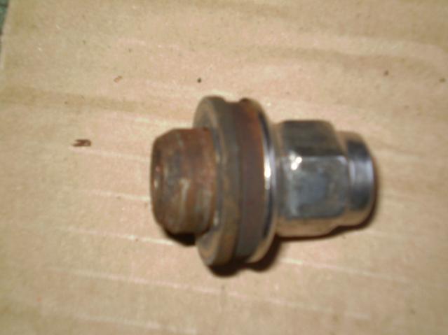

So, I can only upload 5 pictures at a time. Here are a couple of other pictures.
So, my thought on it would be this. Buy another Kronos wheel. You said you'll be getting tires shortly. Buy 5 and go to a 5 tire rotation. I would do this anyway since your wife is making multiple long distance trips by herself. I've always hated temp spares anyway. This way, you keep the lugnuts you like and you don't have to worry about her driving anywhere on a donut.....
Now for a personal question.... What the heck is the little plastic block thingie in the tool kit? There is no mention of it in the owners manual that I can find. It is in the picture named Huh. Oh, and I agree, the factory lug wrench SUCKS. That will be replaced in my tool kit....
Attached Thumbnails Warning:  Lug Nut Issue with Mini-Spare Tire-lugnut_2.jpg   Warning:  Lug Nut Issue with Mini-Spare Tire-lugnut_3.jpg   Warning:  Lug Nut Issue with Mini-Spare Tire-huh.jpg

The plastic block is to chock the wheels - rotate it about its center pin and you'll see.

All of your parts look the same as mine, including the mini-spare and the crappy two-piece lug nuts. But I'm telling you guys, my lug nuts will not reach the metal mini-spare rim before they run out of thread with at least a quarter-inch to go. Last night my wife and I discussed whether her mini-spare may have been swapped out by our local dealership before we purchased the car (she doesn't trust this dealership to flush a toilet much less work on her car anymore). I asked her, "Why would they bother to do that?" She said, "Maybe the original mini-spare was missing and they put the wrong mini-spare in the trunk to sell the car without checking to see if it worked." Can't argue with that, she may be right....

If the wheel's correct and the lugs look as jag shipped then maybe the studs (captive bolts) are wrong? It would likely mean a hub/bearing was replaced, and not with the proper part.
