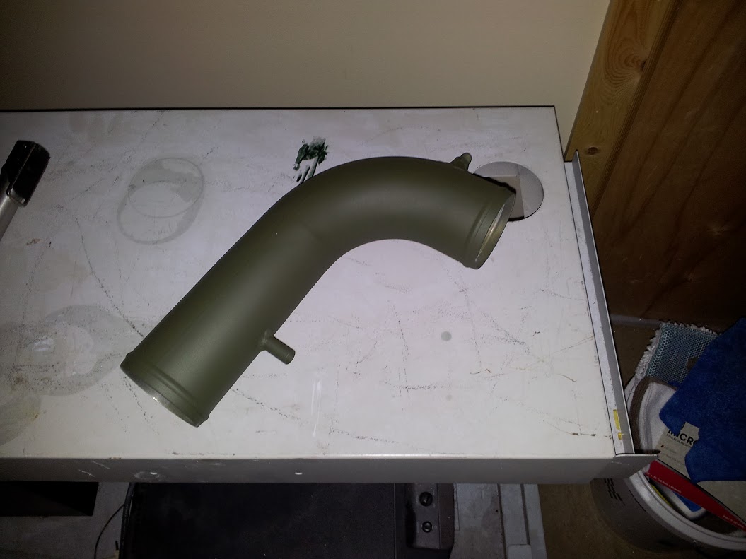

And since I can't leave things looking bland:
Attached Thumbnails What have I gotten myself into....-img_20130502_171541.jpg   What have I gotten myself into....-img_20130502_171626.jpg

Pretty Cool!!
What did you use? Paint/Powder coat?

I hate to admit it, but it is flat camo green....
Attached Thumbnails What have I gotten myself into....-krylon_spray_fusion_woodland_light_green_flat_camo.jpg

eh... maybe rethink that color... but kudos on going *****-deep into the pulley job, lol!

With the color, I hate to put things back dirty, and I figure with a green car my choices are limited. I think it will look ok (per my mind's eye) but I guess we will see once I gt it all back together!

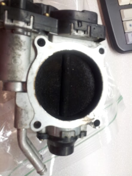

Also, when I pulled off the TB it looked like this
That seems like a lot of oil circulating through the intake track.
Man.... You Jaguar guys need to start running catch cans!
Remember-Modern PCV systems dump into the intake stream instead of into a filter in the air box like they used to (old folks like me remember cleaning that oily filter stuff in our air cleaners).
Most normal drives don't react that bad but those that are driven a little more enthusiastically tend to blow off more pressure therefore end up with a bunch more oil residue.
I'll snap an actual picture of my throttle body the next time I pull the intake tube, but lets just say mine is squeaky clean.
Here is what I use.
Billet Technology Signature Series Catch Can 5.7 or 6.1 Hemi Engines
The neat thing about theirs is that it is all metal, including the filter media.
Very simple to install just need a place to mount the bracket. I'm sure if you talked to Billet Technologies, they could help with the right hose fittings and a bracket.
Oh, and this isn't the first time I posted about this.... LOL
Here is what I use.
More pictures to get you thinking...
That might be a very good idea. For a car with 75k miles on it, mine looks horrible.

your meth injection kit will have the added benefit of keeping intake tract clean as well though... catch cans in-line with the pcv system are a good idea too though,

I did start to see where some things were pretty clean with the meth kit, but the amount of oil crude on the butterfly was crazy. The piece from the tb to the aftercoolers was just as bad. I am sure the aftercoolers are horrible too. I am going to try to soak as many parts as I can to clean them.
Mine just turned 80k and clean as a whistle.
It would probably help the 3.0 guys as well since their oil pools in the intake manifold and leaks out the IMT valve....
I found out about the Billet piece when I got my 300. It is all over the forum there.. Pictures of the oil they collect and pictures of clean manifolds and throttle bodies..
I was skeptical at first. My car was in the 36k range when I bought it and was already showing some crud on the throttle body. I cleaned it, and added the catch can for the "heck" of it. I empty it out at every oil change. And clean it once a year. My intake looks great ever since..

I like the color, reminds me of the inside of F-16's I used to work on. Only alittle more yellowish. Gives it and industrial look
