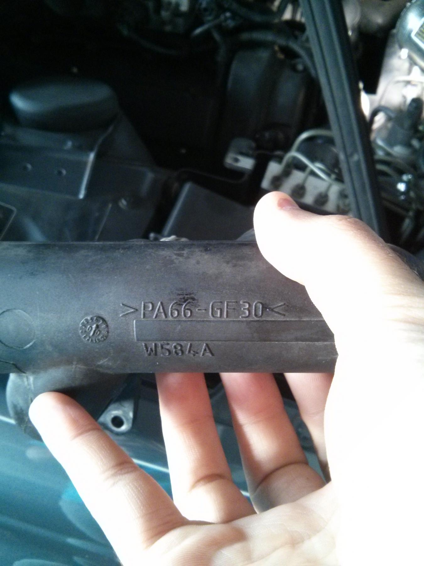

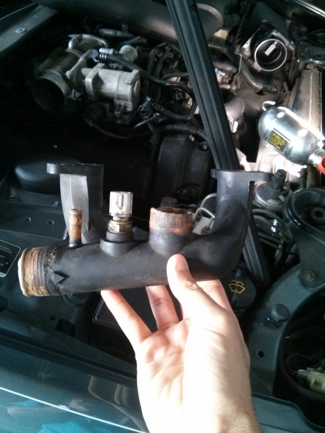

I Cant seem to find this part online, results just give me radiator results... my mechanic told me that i need to replace this tubing that connects to the radiator.. im trying to save a couple bucks and buy it online, can anyone help me ? I have a 2001 S-Type 4.0 ( and LS parts that match ? )

Jaguar Engine Coolant Water Outlet - Eurospare, Original Equipment at Auto Parts Network
$48. Good luck
PA66 GF30, which means it is made from 30% Glass filled polyamide66, a grade of polyamides.
