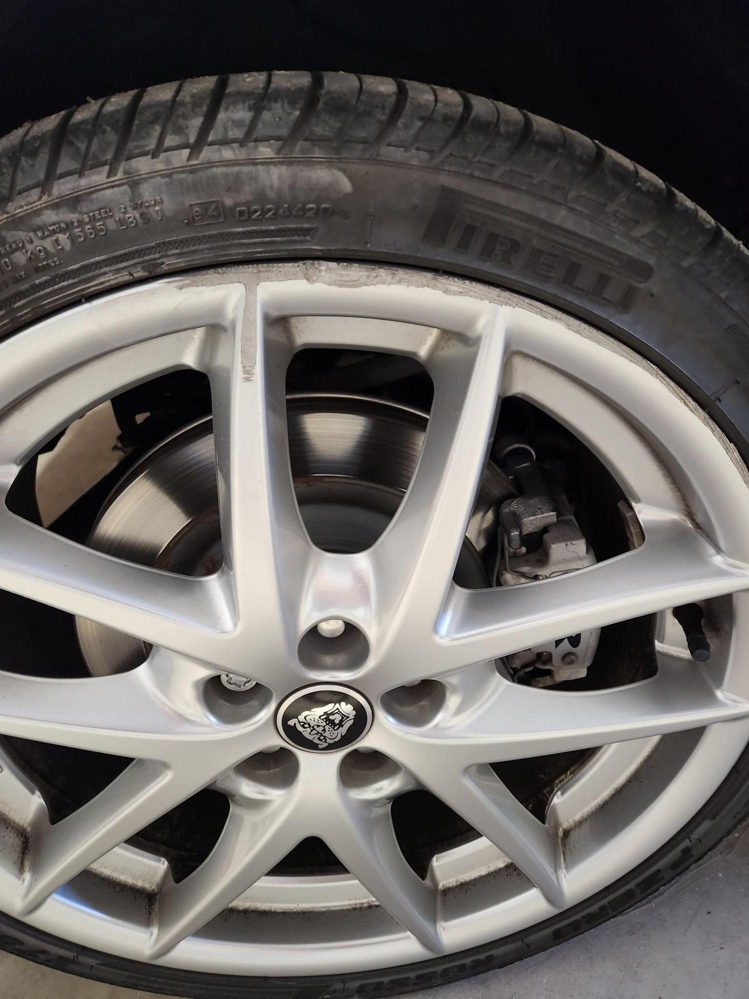

Can someone help identify the name of this wheel on a 07 STR?
​​​​​Thanks

The ‘Barcelona’ made by BBS for the STR
Also, a proper wheel shop should be able to repair that wheel

Yes that is a 19 inch 'Barcelona' BBS wheel.
Fronts are 8J wide rears are 9.4J inch wide.
Part numbers:
Front 8J : XR851963
Rear 9.5J : XR853029 (These were still available from Jaguar until about 18 months ago at £346.42 each.)
The STR's from January 2006 build onwards were the only S-types to have these as standard.
However, the smaller front 8J size were available as an expensive option for the rest of the S-type range.
(I have seen a 2.7 diesel in the UK with them fitted.)

Thanks for the quick replies. I'm thinking of buying an 07 STR that appears from the pictures to be in excellent condition except for the right side wheels. Looking at my options for replacing/repairing those two. Could be a bargaining tool. Thanks again.

One of our best local wheel shops charges a flat $150 per to repair, repaint, and powder coat clear.
