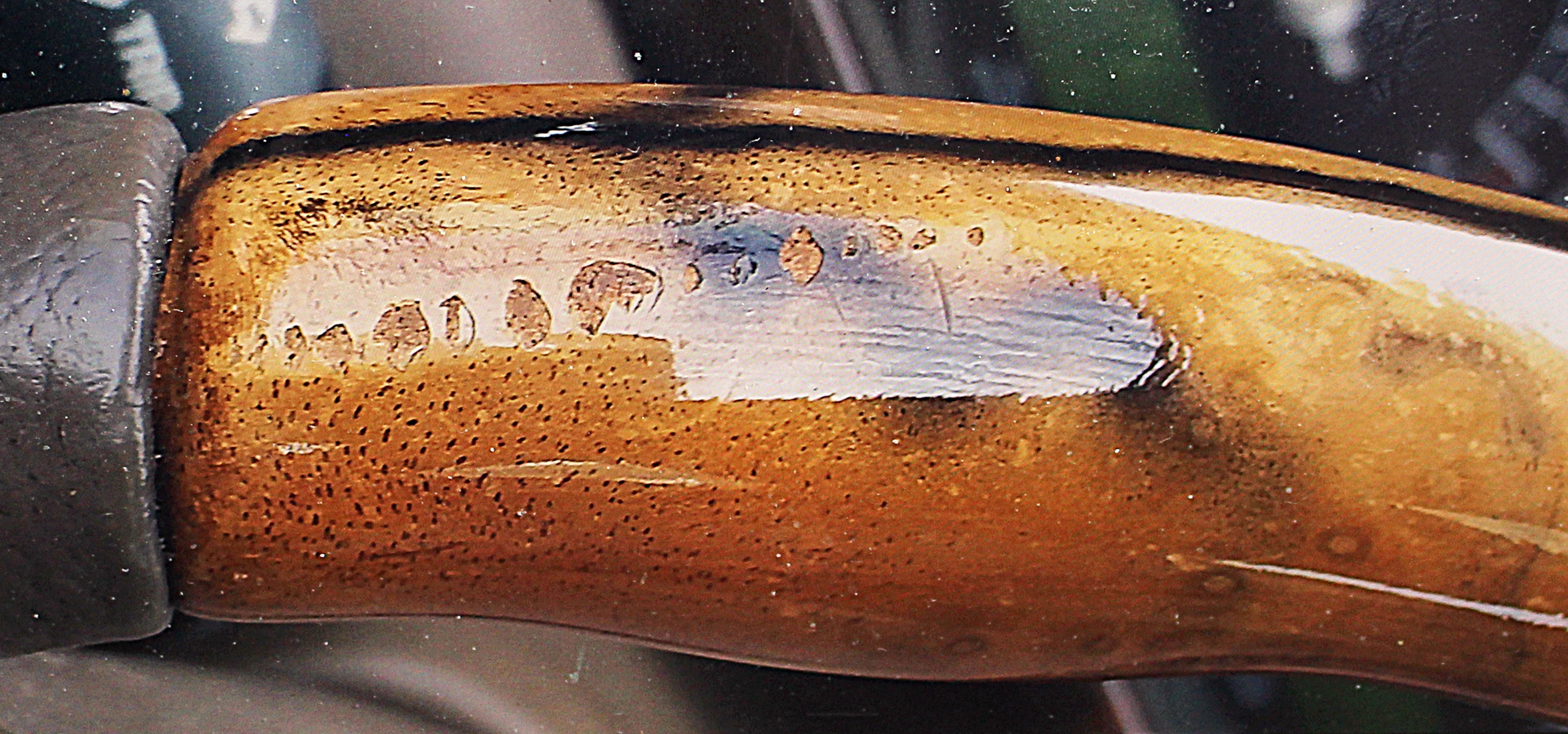

Sooo, my 17k mile had a grease monkey scratch the finish right where my left hand sits somehow-they never even got to mount my tires by days end. It has about 10-15 small chips in the finish only so no wood damage.
Anyone ever fix their wheel finish? I'm pretty good at woodwork having owned a big antiques importing shop but I know some of these new finishes are polyester, not polyurethane.
I'm thinking I can fill in the chips with a matching finish(not stain) and then color sand it down smooth.

If I were doing it myself, since it appears only to be scratched lacquer, I would have the steering wheel off and float lacquer in to the depressions using a cocktail stick or similar. It contracts a lot as it dries so will take a number of applications. Obviously you would have to read up about disabling the airbags.

We've had a fine antiques shop for 45 years but me, myself, an amateur finisher. I think I'll sand this one smooth and overlay the bare wood with gloss water base urethane. This is likely an OEM polyester finish.

With your knowledge there's no reason you can't repair those chips yourself. Guitar luthiers face these kinds of issues all the time. Here's a link to a lacquer-fill repair like mikefarnham suggested:
Lacquer Drop Fill
And if you're concerned about compatibility with the UV-cured finish on the wheel (whether it's polyester or polyurethane), here's a link to a method using cyanoacrylate (super glue) that should work with either one:
Super Glue Drop Fill
With either method, an important key is to allow the new finish drops to dry as thoroughly as possible before attempting to sand and polish. If you're patient and let it dry thoroughly, you can wet sand to 3000 grit, then rub out with a good polish like Mequiar's Scratch X 2.0 on a microfiber towel to achieve a mirror gloss.
In addition to the clockspring that aholbro1 mentioned, be sure to research the proper method of disarming the airbag before you disconnect it. I just did this on an X308 and that required disconnecting the battery, then waiting a minimum of 3 minutes before disconnecting the airbag. But it may be different on the S-Type.
