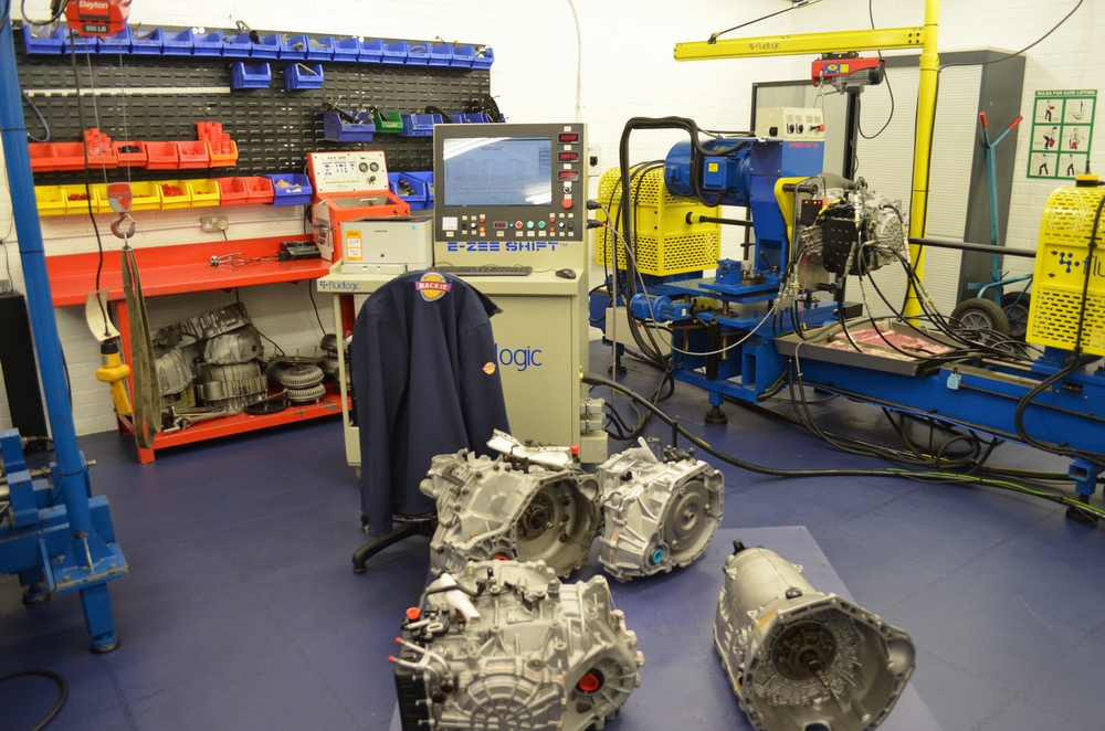

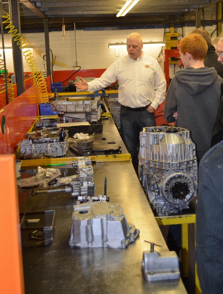

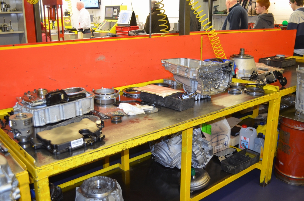

1. Remanufacturing - Automatic Transmissions

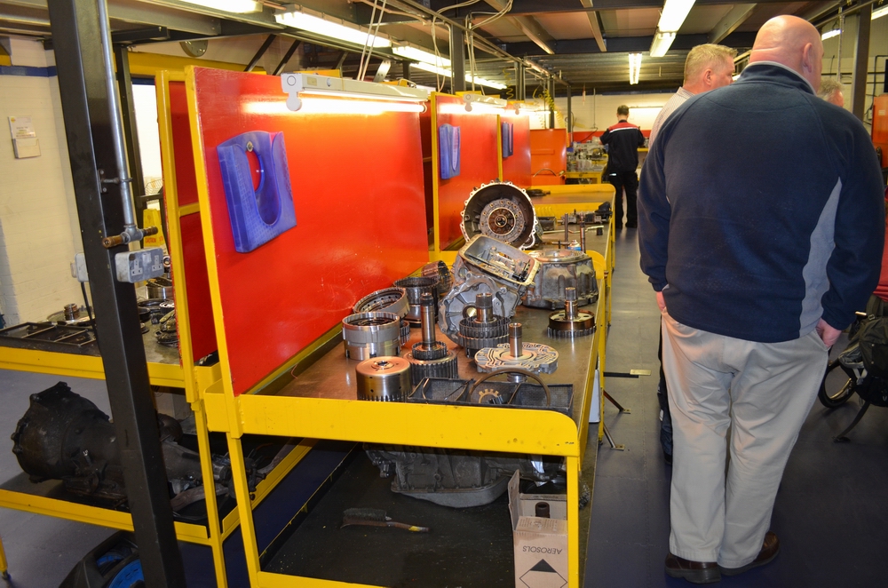

The automatic transmission is totally dismantled and every component is cleaned and prepared for inspection.
From this point on, the entire process is scrupulously clean.
Each component (several hundred of them) is then examined and measured. All components that are not deemed 100% perfect are replaced.
All seals, gaskets, filters high failure components are discarded and replaced with new parts.

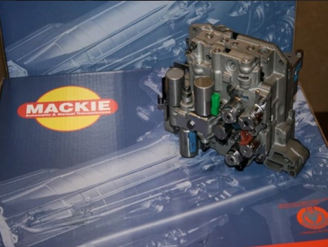

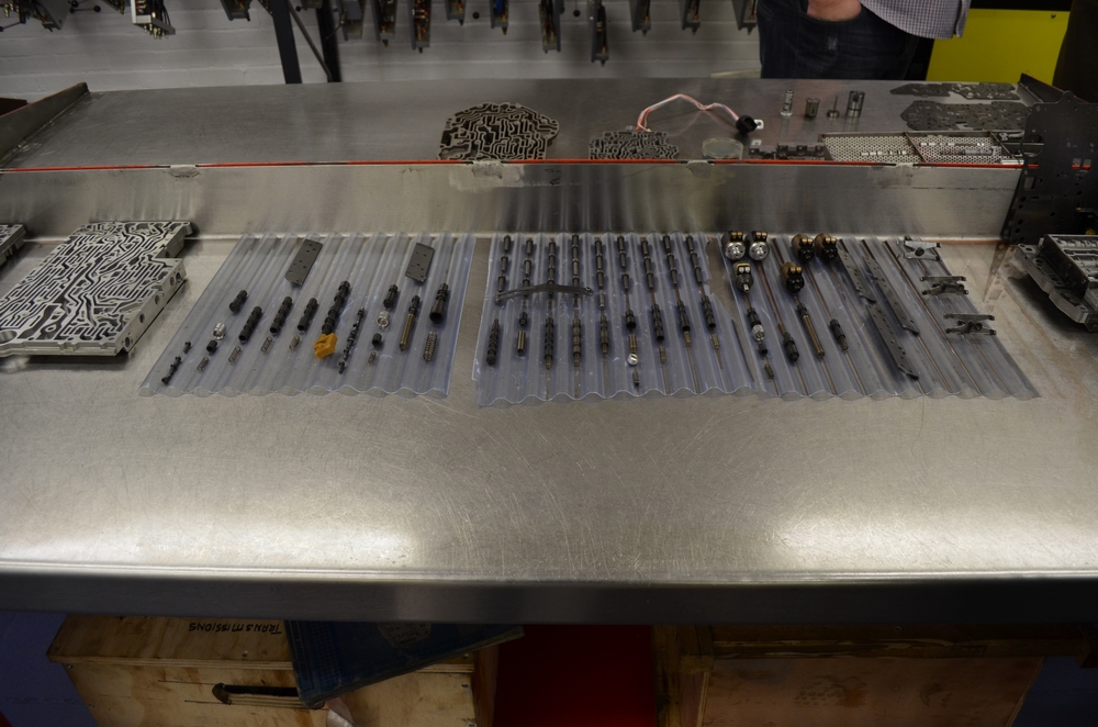

The valve body (control unit) goes through a process that includes ultra-sonic cleaning, vacuum testing, solenoid remanufacturing and final calibration on a unique valve body test station. This ensures that the valve body meets or exceeds the original manufacturer’s specification.

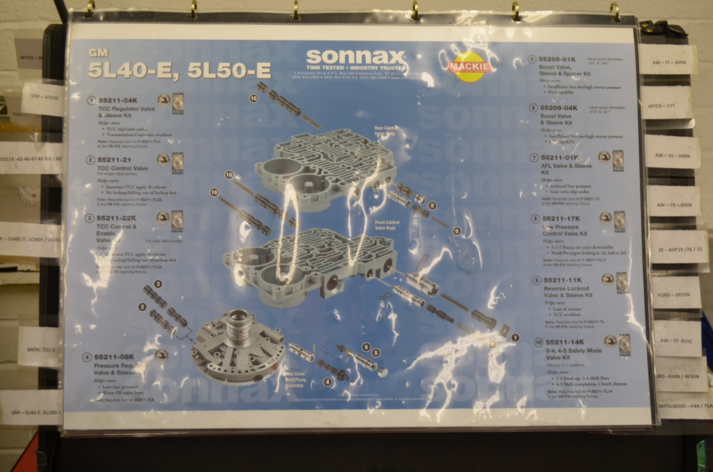

Following component checking, everything is laid out ready for rebuilding the valve body.
For those of us less familiar with the parts in the valve body, this graphic gives a clue to how it all goes together.
During the transmission assembly process, all sub-assemblies are pressure-tested to ensure total hydraulic integrity.

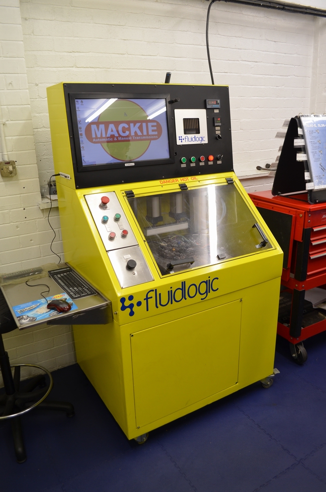

The remanufactured valve body is pressure tested
Each individual gear is subjected to testing. A loss on any one results in the valve body being put through the full strip, check and rebuild sequence again.

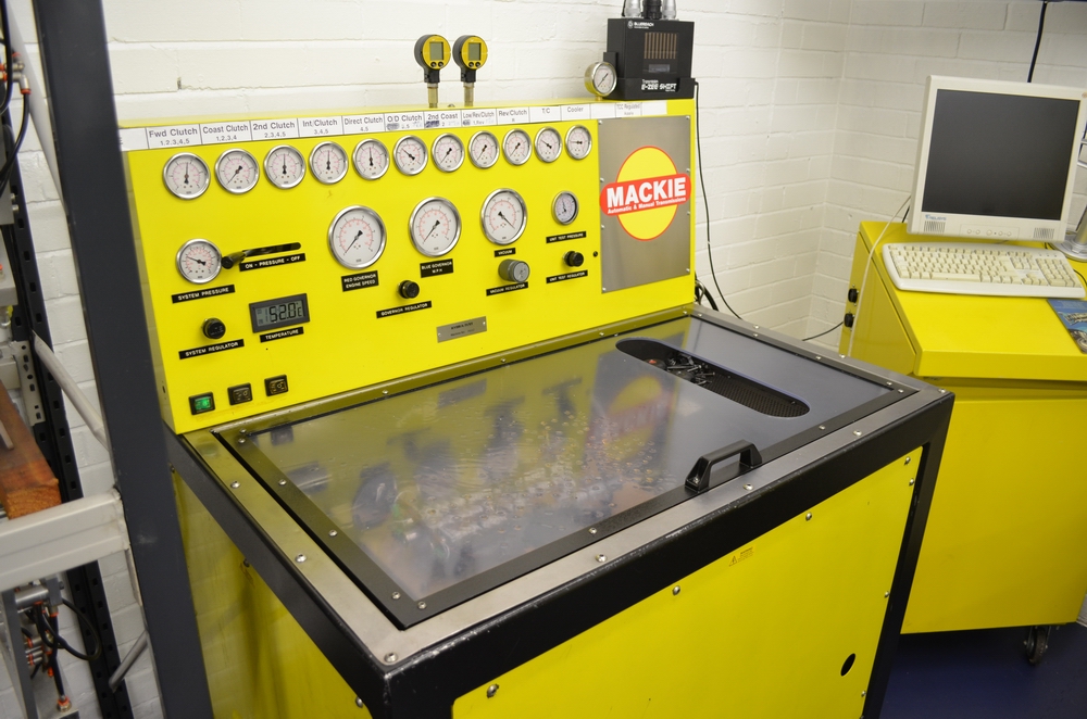

Final calibration with data acquisition is carried out on a unique valve body test station. This ensures that the valve body meets or exceeds the original manufacturer’s specification.
The subassembly is checked through all gear changes prior to final assembly.

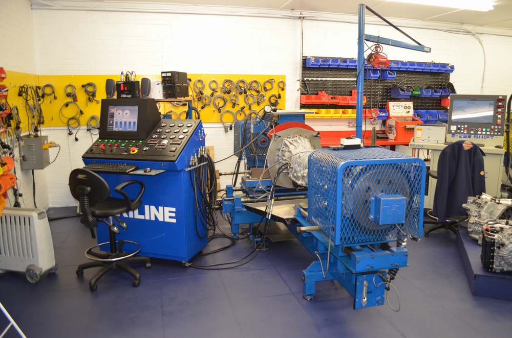

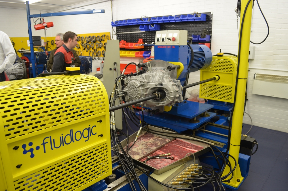

The complete transmission assembly has a final build test on one of two road test simulators that create real life driving situations.
During this stage, the transmission is run at normal operating temperatures for several hours.
The simulator assesses every fundamental part of the remanufactured transmission. Any failed part will instantly be flagged on the test report.
This test procedure almost eliminates any potential failure prior to installation to the vehicle.
The equipment used by Mackie Automatic & Manual Transmissions is exactly the same as that used by the original manufacturers.

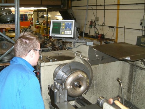

Remanufacturing Torque Converters
Mackie Automatic Transmissions torque converters are supplied with a life time warranty for the vehicle that they are installed in.
To start the process, the two welded halves of the converter are cut apart by specialist lathe operators.
After washing and examination, the unit is re-machined in one of three adapted high-specification lathes to refinish the joining faces.
Mackie Automatic Transmissions remanufacture torque convertors from the BW66 of the early 1970's through to the current 6HP26.
Through this period, the torque converter has developed from a simple 'fluid flywheel' through increasingly sophisticated 'lock up clutches'.
Note the two beakers on the workbench. The one on the right contains new transmission fluid. The one on the left has typical contaminated fluid from a transmission in for service.
Mackie Automatic Transmissions identify where there is a pattern in OE torque converters failures and develop improvements to increase reliability in their units.
The bonded friction lining is removed and a new one is re-bonded to the lock-up plate. This highly specialized process is made possible by a unique bonding machine.

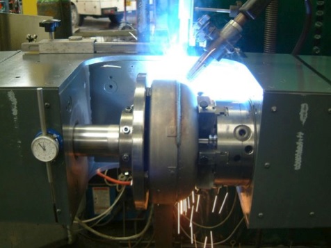

The torque converter is welded back together, with accuracy to a few tenths of a thousandth of an inch.

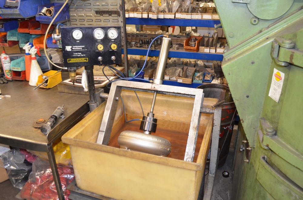

The unit is leak tested to ensure the integrity of the weld is correct and rebalanced to meet or exceed the original manufacturer’s specifications.
This equipment test for glycol contamination. Not an applicable part of the process once a transmission has been stripped and cleaned.
The torque converter is shot-blasted to restore a perfect satin steel finish. A coating of anti-rust and an etching identification number is applied to the finished unit.
The remanufactured torque convertor is guaranteed for the life of the vehicle in which it is fitted.

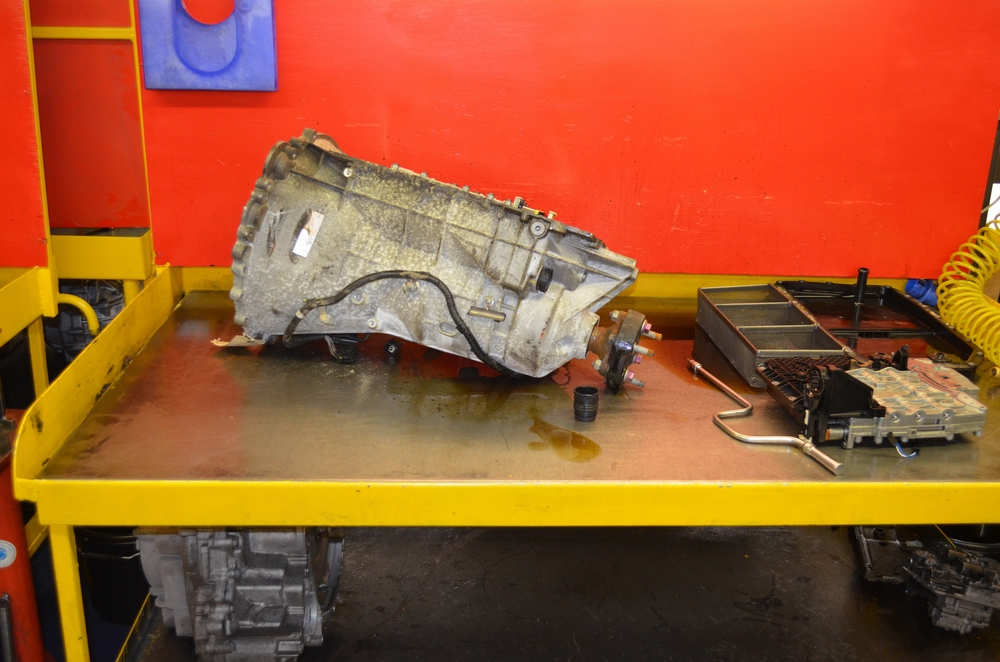

Mackie Automatic Transmissions receive complete vehicles from dealers and individuals for everything from the standard fluid change through fault diagnostics and repair to complete transmission remanufacture.
Our host for the day, Managing Director of Mackie Automatic Transmissions, John Mackie explained that many automatic transmission issues are due to:
1. fluid overheating
2. fluid contamination (with engine coolant)
3. software
Autologic is their preferred diagnostics tool.
After retrieving stored and pending codes, these are cleared and the vehicle taken on a 5 to 8 mile drive. Any reset codes are used to diagnose faults.
Reflashing the TCM is a routine procedure and the latest updates are always applied.
Fluid changes are recommended at 25K miles intervals. This is considerably more frequent than most members are applying to their vehicles. A Hot Oil flushing machine is used.
The fluid lines are disconnected on the vehicle at the cooler and the fluid drained. It is then connected to the Hot Oil machine.
The remaining old fluid is pumped out and the transmission refilled with fresh fluid at the correct temperature and volume.
