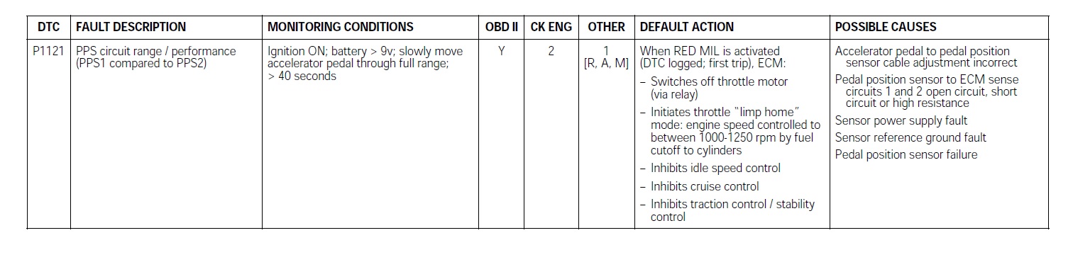

Thanks for that Graham. I haven't updated this thread yet as I'm pursuing several options at the moment. I fitted the new TP sensor during the week and managed to set up the throttle and all seemed well. Then the problem re occurred and I had the same P1121 code again.
I then realised my mistake: my Autel code reader which is installed with manufacturer specific codes shows P1121 is the Throttle Position Sensor Circuit Intermittent High Voltage but.....the Jaguar DTC Summary in JTIS says it is the Pedal position sensor misreading between the two circuits. I've been chasing the wrong problem!

Old Nov 21, 2015 | 05:19 AM
Andy,
Here's the Jaguar DTC extract for P1121 on 2001MY:
Note there's 5 Possible Causes and not definitely only an indication of an imbalance between PPS1 and PPS2.

Thanks Graham, I've got that on my laptop, just wished I'd gone back through the DTCs and not let myself get led astray by my code reader!
