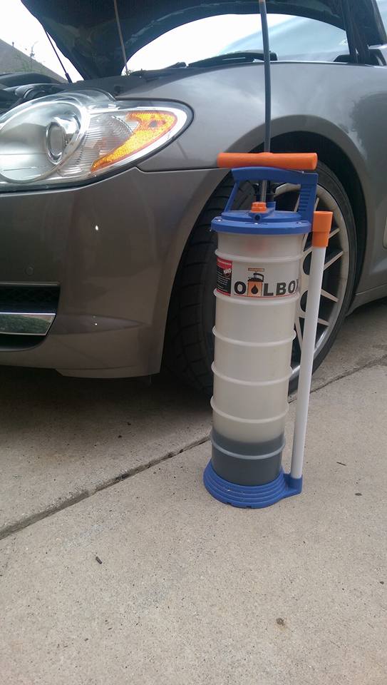

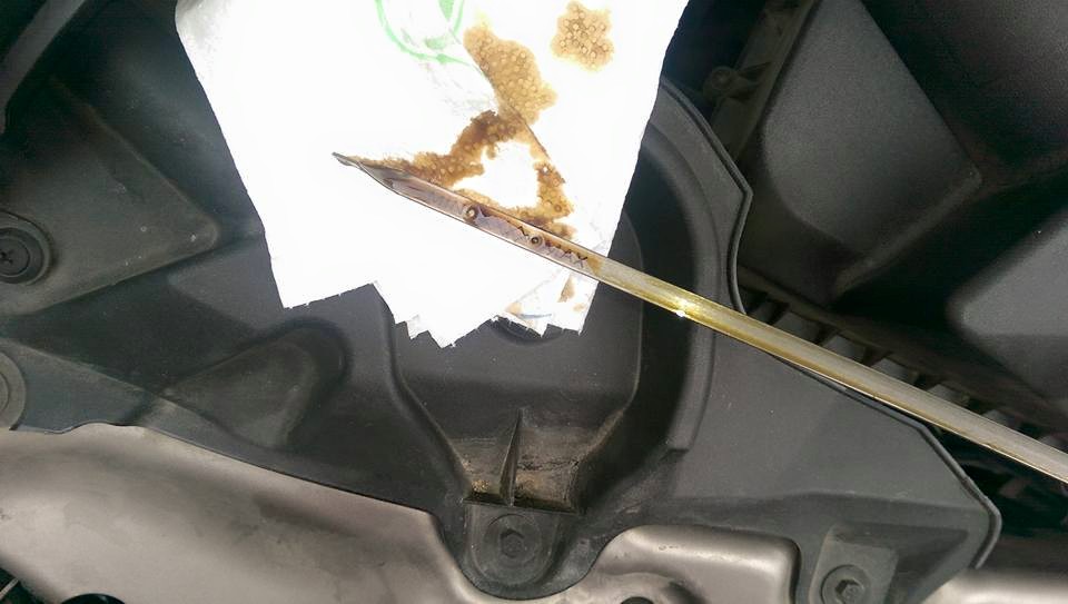

Update: I decided to check my oil to make sure they'd actually filled it while they had it. It turns out they had:
I've sent the service writers an email:
While I appreciate the foresight of putting a couple of extra quarts oil in to help protect against running low in the future, I'm not sure it's a sound mechanical practice. How should I go about returning these extra quarts of oil for a refund?
Also, since it turns out the low oil sensor is calibrated in the XF to come on with less than 2 quarts remaining, and mine was not on when I brought it into the shop, it's only fair to assume that Jaguar's position is that the amount of oil in my car shouldn't be low enough to cause damage, or else they would likely need to recall and rectify the low oil sensors to come on higher.
For your technicians who can diagnose failed crank to rod clearance through the powers of his experience alone without benefit of machinist tools, it may be useful to review the symptoms of a failing VVT unit, as well as oil filling procedures. I find we can all benefit from a having additional experience to draw from. I know mine has been educational.
