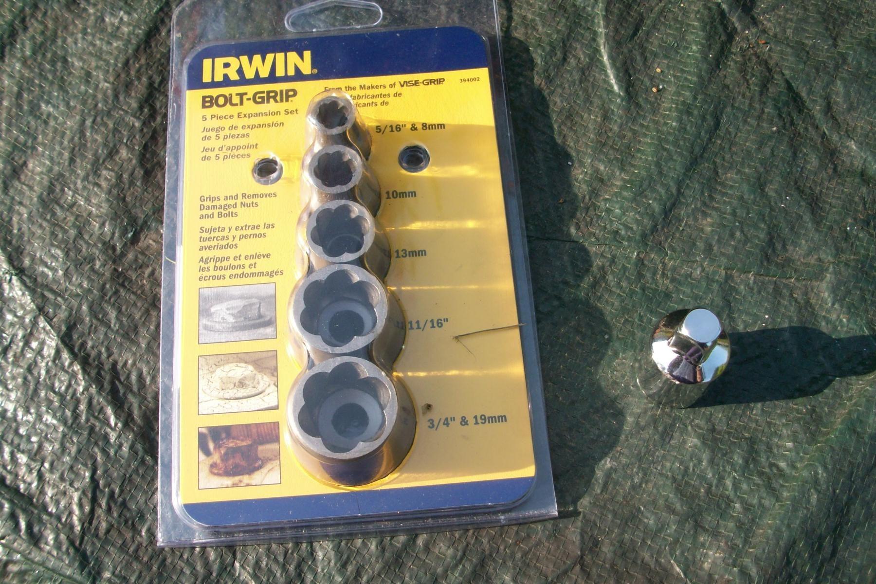

There is a very good video, easily found on YouTube, of an American removing the domed style nuts entitled:Jaguar Wheel Lock Removal. Most importantly he resorts to using Irwin Bolt grips which are excellent.

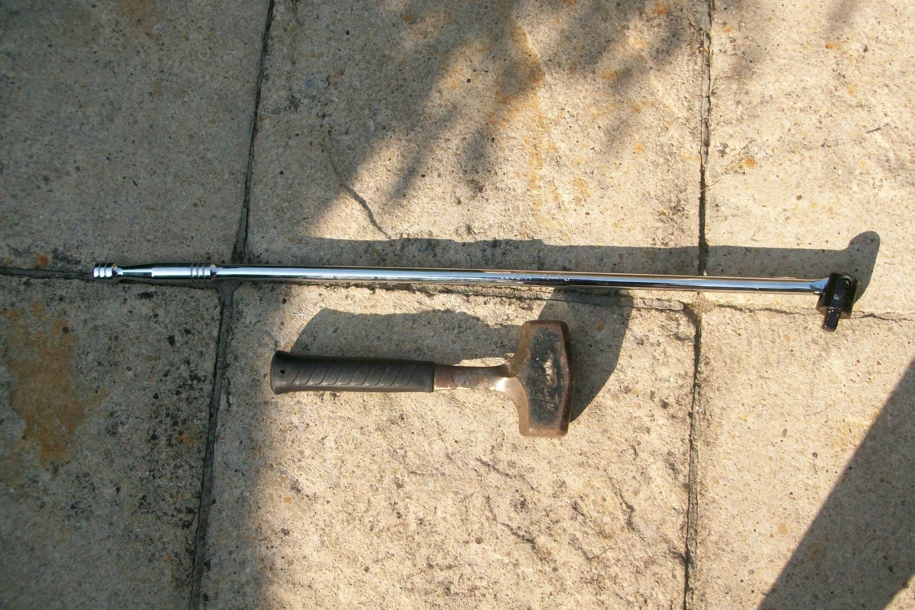

As well as using that the above I also employed a long breaker bar, a 1/2 to 3/8 inch adapter, a Sealey 19 mm socket and some block pavingbricks would do just as well.
It is important to get the offending nut at the correct height by moving the car so that the bricks can be stacked up such that the socket, when attached to the breaker bar, will sit directly on the nut and not angle down. Be sure to place the blocks so that the socket and breaker bar can still rotate anti-clockwise!
Anyway I whacked the Irwin Bolt grip 3/4 inch onto the nut making sure it was on straight, arranged the block paviers, located the socket, got my friend to put his foot on it and then got hold of the end of the breaker bar. It was still very hard to move! In the end I did what I usually have to do and stood on it. Then came the relieving noise of the creaking given out by a nut which was overtightened releasing.
Of course when I got it off then I was stuck fast to the bolt grip but when I tightened it again it released easily and the nut was then loose enough to remove once more.
I decided to make this post because the tools worked very efficiently and I rather wish I had taken this approach in the first place before I broke two locking wheel nut key is costing a fortune. Incidentally If you need to perform the similar operation having cut the dome off one of the newer keys it is the 11/16 inch bolt grip you will need to fit onto the central shaft.
