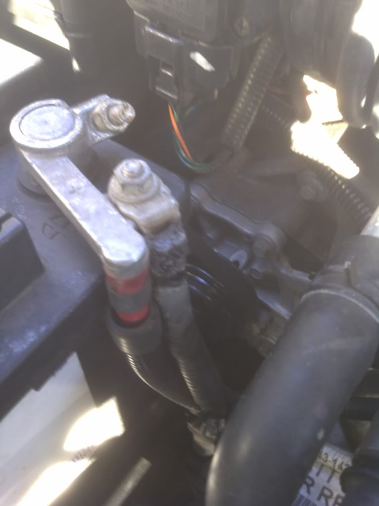

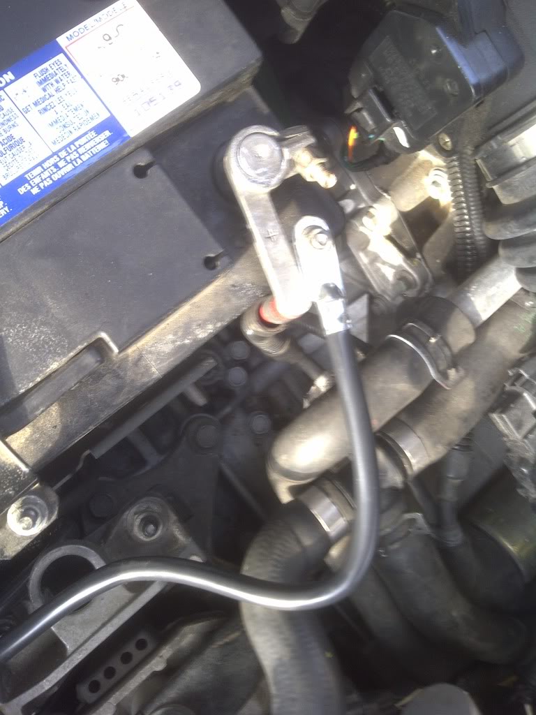

i think i found the problem, the + cable going from the bat terminal to the fuse box looks like it was about to catch on fire.... replaced it with a generic one for $15 with tax.
the only thing i had to do was bend the eye connector on the end that goes into the fuse box...i could bend the end on the battery a little but there isnt really a point...it sticks straight out and its not in the way of anything...sure beets dealership prices.
new
