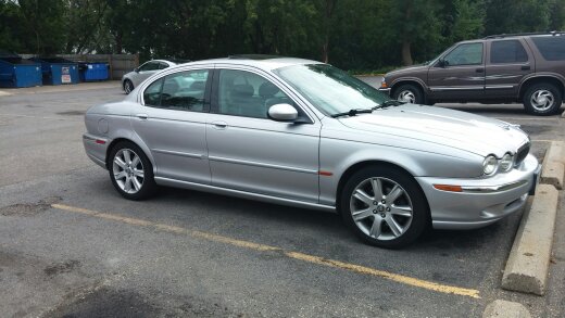

Again, thank you for any help! also pictures of the car, bought it for 2500, 141k.
