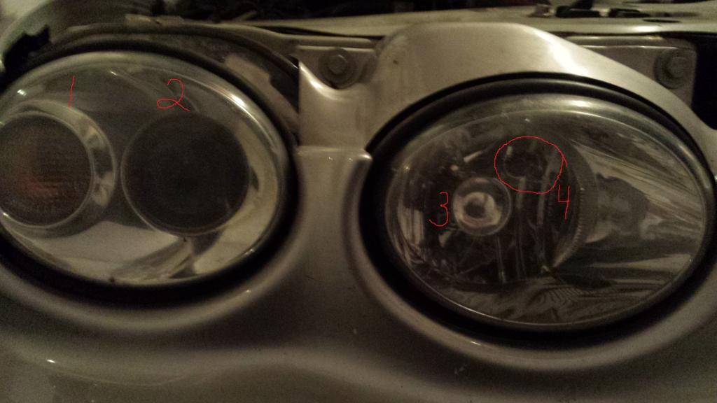

Hello! I recently just bought an 04 X-type and it has a bulb burnt out. I have been reading a lot on this form in different headlight threads, but I got a little confused with the different names for different bulbs in different countries so I figured I would cut to the chase with an easy picture.
As you can see I have labeled all 4 bulbs. My issue is with bulb number 4. When I turn my lights on, bulb number 4 does not come on. I have taken off the circle twist of cap to expose the inner bulb housing.
Here is my issue: It seems the bulb receptacle just spins inside of the housing. I've pulled back on it but the whole housing moves and I didnt want to break anything, especially since im in WI and it's cold.
Is there a trick to getting the #4 bulb assy out of the housing? Thanks for your time

1. Direction indicator
2. Dip beam
3. High beam
4. Parking sidelight

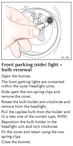

Thank you for that post. I missed it. I guess I was just being a little TOO careful. Got her out, new one in. Issue solved. Thank you very much
