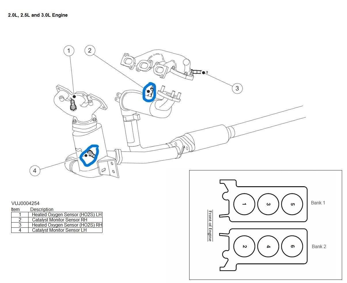

Understood on the upstream sensors being Denso as I assuming that they are also acting as widebands? Therefore more specfic data comes off of them? I went off what the code was saying which is why I swapped what I believed was Sensor 2.
Also just to confirm before I swap anything else out, the ones marked in blue on the drawing are "downstream", correct?

Old Mar 3, 2024 | 01:14 PM
xalty's Avatar
Joined: Dec 2019
Posts: 3,695
Likes: 1,221
Originally Posted by extheaterkid
xalty, thanks! really appreciate the assist on this.
Also I took the car out today and did 120 miles or so of mountain and city running to try and confirm what data I was getting back from OBD2:
Details are below:
Double checked under the car for any exhaust leaks; no obvious ones with it on ramps or while poking my head around the center section.
  • Long Term Fuel Trims (bank 1-2): 0.0 (these stayed rock steady the entire trip)
    • My understanding is that these shouldn't move much at all, correct?
  • Short term fuel trims (bank 1-2) (idle): varied between high of +10 down to -13
  • Short term fuel trims (bank 1-2) (2500-3K rpm): varied between high of +22 down to -18
  • Bank 1 Fuel trims: steady at 0.78 with very slight variation down to -1.56
  • Bank 2 fuel trims: fluctuating a little more between 0.78 and -1.56
car came up to temp (185-206 deg) just like normal, AFR stayed between 13 and 18 most of the time and it did indicate that it did switch from open to closed loop on my reader.
Thoughts?
now look for your downstream fuel trims. should say fuel trim bank 1\2 sensor 2

xalty, the data I am getting from the monitor labeled fuel trim bank 1/2 sensor 2 is running between +0.78 and -1.56 mostly holding at 0.00 for seconds at a time.
