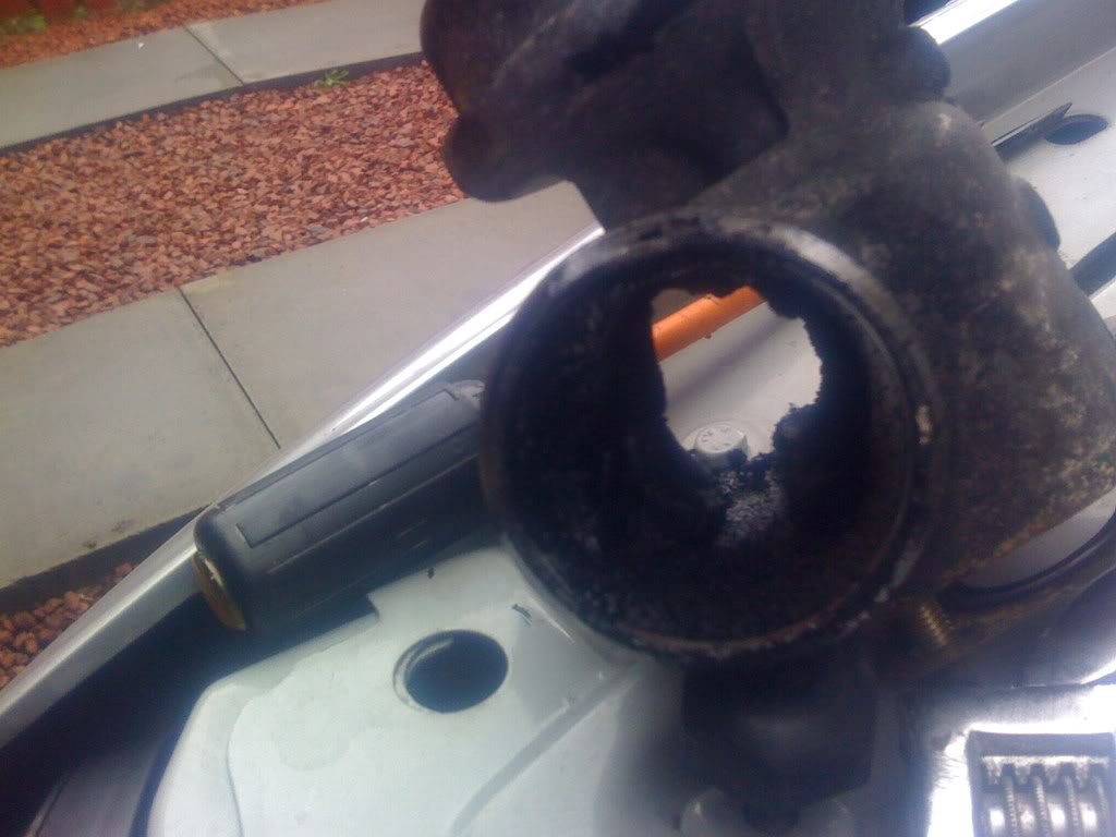

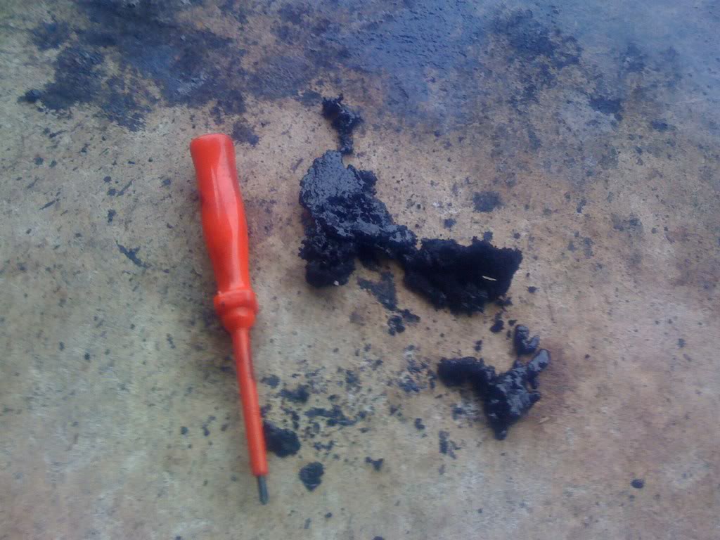

Hi Bill, sorry mate, just saw this.
I was actually going to suggest the EGR valve, you say it was a split in the pipe?
Have they removed and cleaned the EGR valve?
If not and depending on your mileage it may be a worthwhile investment to remove the EGR valve and the inlet manifold and get them totally cleaned out, they're probably full of carbonised soot.
If you have some tools anddo a bit of tinkering this is something you could probably tackle yourself with a tin of carb cleaner ( around £5 )
I've included a link below to one on an Audi that shows what it can look like ( almost worst case scenario ) and then cleaned up & what it should look like.
http://www.google.co.uk/url?sa=t&rct...f1h0Re5b4n3cQw
Basically, it gets clogged up and stops the valve from working correctly, becomes sticky, causes black smoke and can cause over fueling too, perhaps in decrease in mpg?
If your car is high mileage and you intend to keep it for quite a while it may be something worth looking into?
For now, sounds like you're all good though.
X type before and after below for you......
Valve out
Gunk
Nice and clean
Cleaned out with paraffin...Messy job but only took a couple of hours. Easy to do, i found it a lot easier once i lifted the airbox out of the way.
Attached Thumbnails 06 Diesel X type 2.0 black smoke when foot down-egr4.jpg   06 Diesel X type 2.0 black smoke when foot down-egr2.jpg   06 Diesel X type 2.0 black smoke when foot down-egr3.jpg   06 Diesel X type 2.0 black smoke when foot down-egr1.jpg   06 Diesel X type 2.0 black smoke when foot down-egr6.jpg

Hi Jim,
no problem, thanks for the photos, that was exactly the same as mine, I didnt think I would ever see one so bad again, its amazin the difference its made, they did remove the EGR valve and cleaned it, they used some kind of solution maybe the same stuff, I did think at the time that pictures may help others here but didnt have a camera with me.
its good to know you took the time to take some, I'm sure it will help others, I didnt even know where to look for the EGR valve until today
I think you may be right about having the manifold cleaned. I will have a look to see if I can do it.
thanks again
