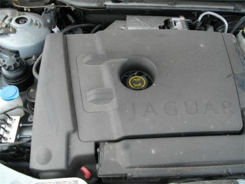

what is the bump on some engines just to the left of the dipstick, mine has not got it but some have that are both older and newer registrations than mine?

There is an EGR valve under it. Some models (mostly older ones) have a vacuum operated EGR valve (without the bump. Egr valve has a small vacuum hose attached to it). Some newer ones have an electric EGR valve (with bump. Small electric connector on top of the valve, under the bump)
