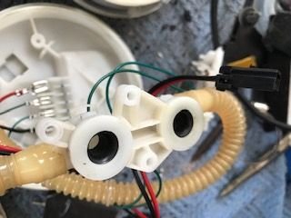

I think I found the issue with this low fuel pressure problem. It would appear that the previous owner decided to fit a 'close enough' fuel pump assembly (GOSS GE241), It's identical but, doesn't have a pressure regulator built in like the Jag 2.1 version.
Effectively it's running without any regulator and just cycling fuel via the 'tee' fitting next to the fuel filter! Tested by squeezing the return line at the tank and sure enough pressure jumped up to 50psi and, finally have an engine that runs properly. Sort of.
Such a simple thing, took a while to notice the difference in the pumps.
Last edited by Tavita05; Mar 9, 2024 at 05:49 AM. Reason: added pics of offending pump

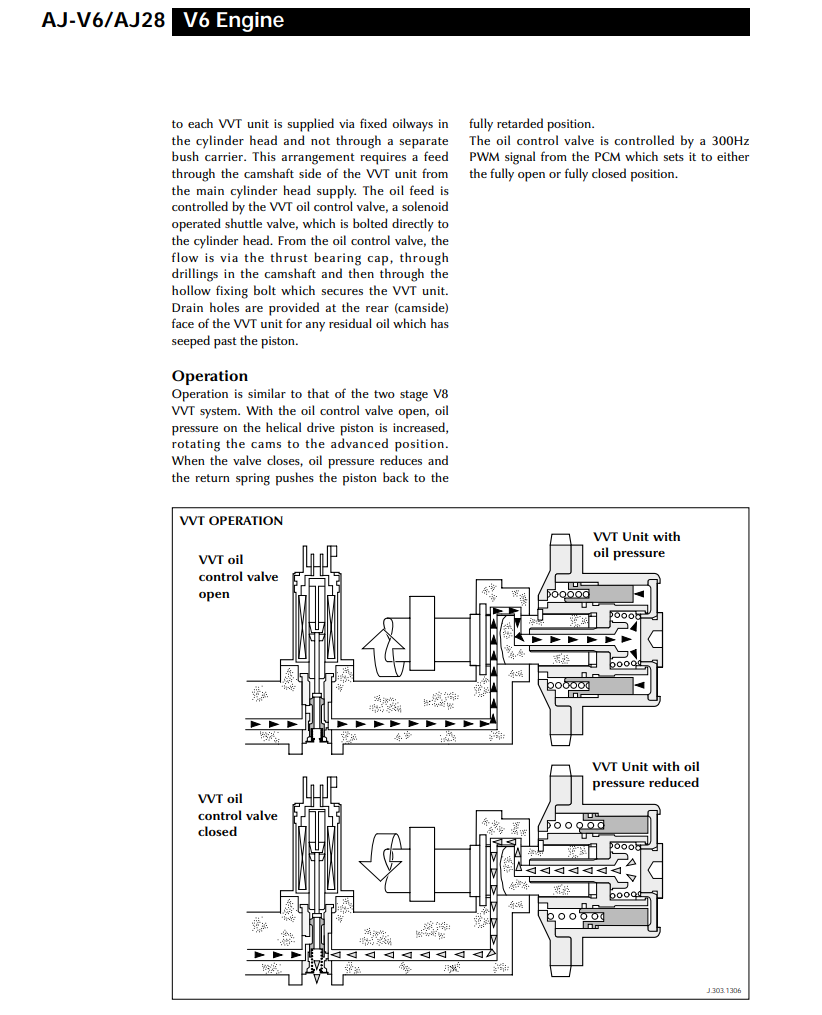

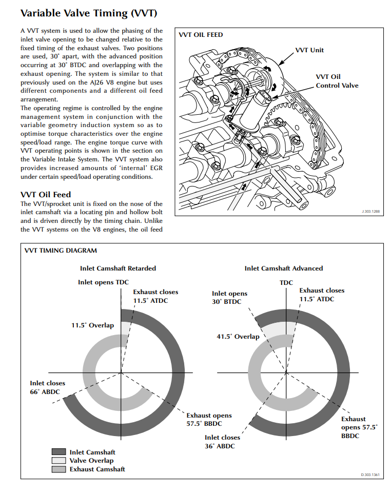

Thanks Mark, sure has been an informative few days researching the vvt system, it's practically same as the mazda6 and some other vehicles. It appears the vvt solenoid valve is usually the culprit but not in my case. The vvt unit on front of the intake cams rotate the cams 30degrees advanced when oil pressure is applied via solenoid valve (around 5000rpm). When pressure is removed the cams will return to 0degrees. A sticky or faulty vvt unit seems to be the noise. Would be nice if it could be removed/replaced without having to pull engine or open front timing cover.
