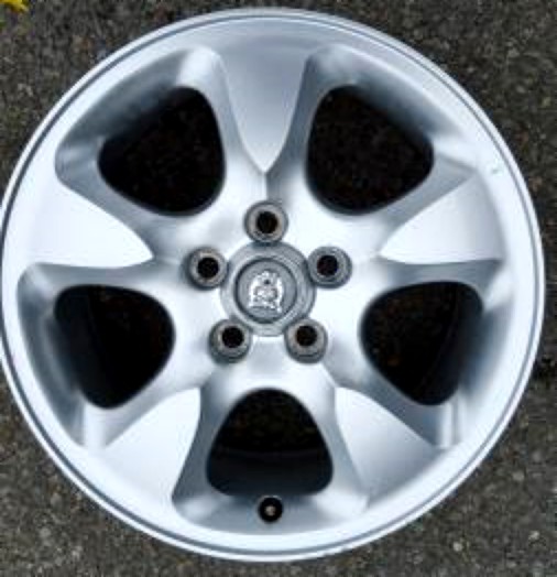

As near as I can tell, these are 5 x 108, and look like they were available on both cars, but are the offsets the same?
Just 16's for 16's, full set available fairly close by for about the price of having my two damaged wheels straightened (yes, she did it AGAIN!)...so if they'll fit...

As I recall, the S Type offset is 50mm; X Type is 40. I suppose you could run spacers, but I'm not sure if that's a terrific idea. Kind of a bummer; there are some great looking wheels on the S Types!
