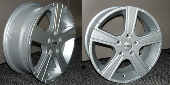

Would you be interested in wheels like these? The OEM 7 Flute 17x7.
All 4 wheels have curb rash. There is a dent on one lip toward the underside of the car...very small. All 4 have center caps. There are summer tires on them with tread left.
If not...I purchased Momo Winter last year. Here is the thread with pictures of the wheels on the car -> https://www.jaguarforums.com/forum/s...ad.php?t=10126
Let me know if you are interested in the Flute wheels.
Attached Thumbnails 2003 X-Type wheels advice-7flute.jpg   2003 X-Type wheels advice-momowinter.jpg

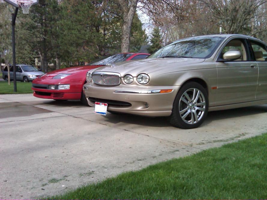

I have those exact wheels for my X. I use them with as my winter wheels. They look great
Old Sep 26, 2009 | 07:22 PM
DZtt's Avatar
Joined: Jul 2008
Posts: 123
Likes: 11
From: Dayton, OH
Here's a pic of my X with these wheels. Taken with my phone so its not the best, but you get the idea.
Attached Thumbnails 2003 X-Type wheels advice-copy-img00014-20090418-1735.jpg

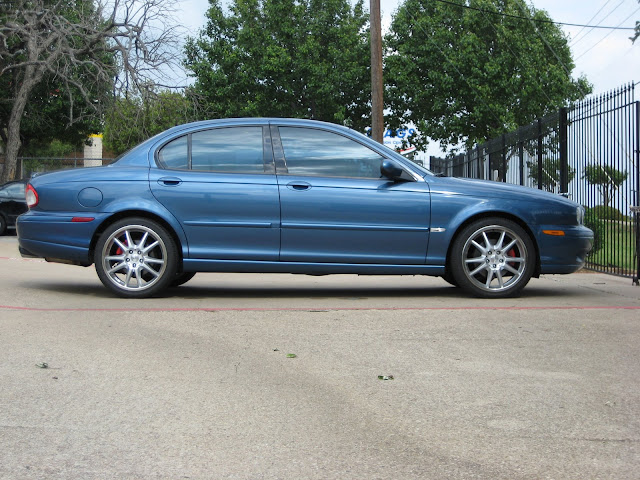

Whatever you do try going for the best winter weather tire you can find (all season tire that has best ratings in snow.) Too bad you didn't go 18", they add a lot of look without affecting the ride too bad. Either way those wheels are very similar to some stock jag wheels so they will look good.
Here are some 18's I had on mine...
