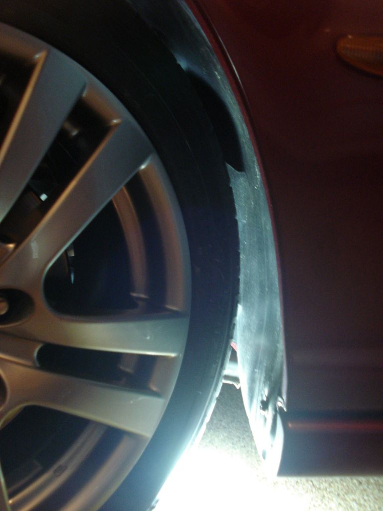

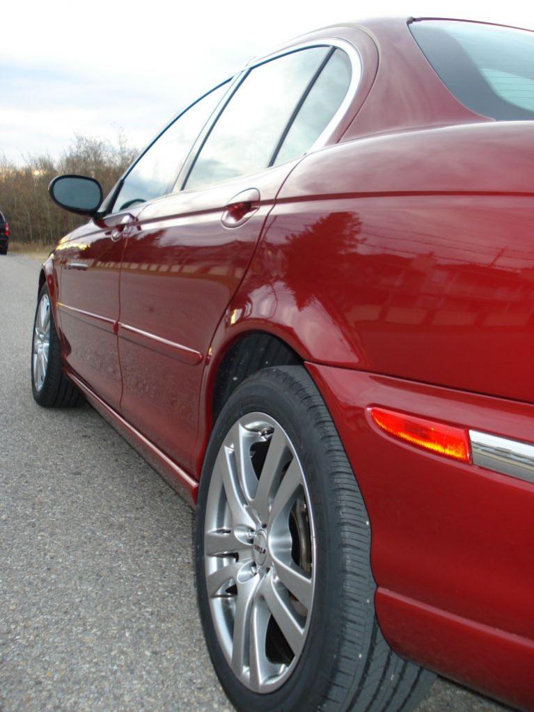

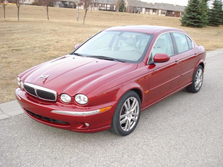

AFTER, with the RIAL COMO 17" wheels with 225/45-17 tires.
Attached Thumbnails 2003 X-Type wheels advice-04.jpg   2003 X-Type wheels advice-05.jpg   2003 X-Type wheels advice-06.jpg

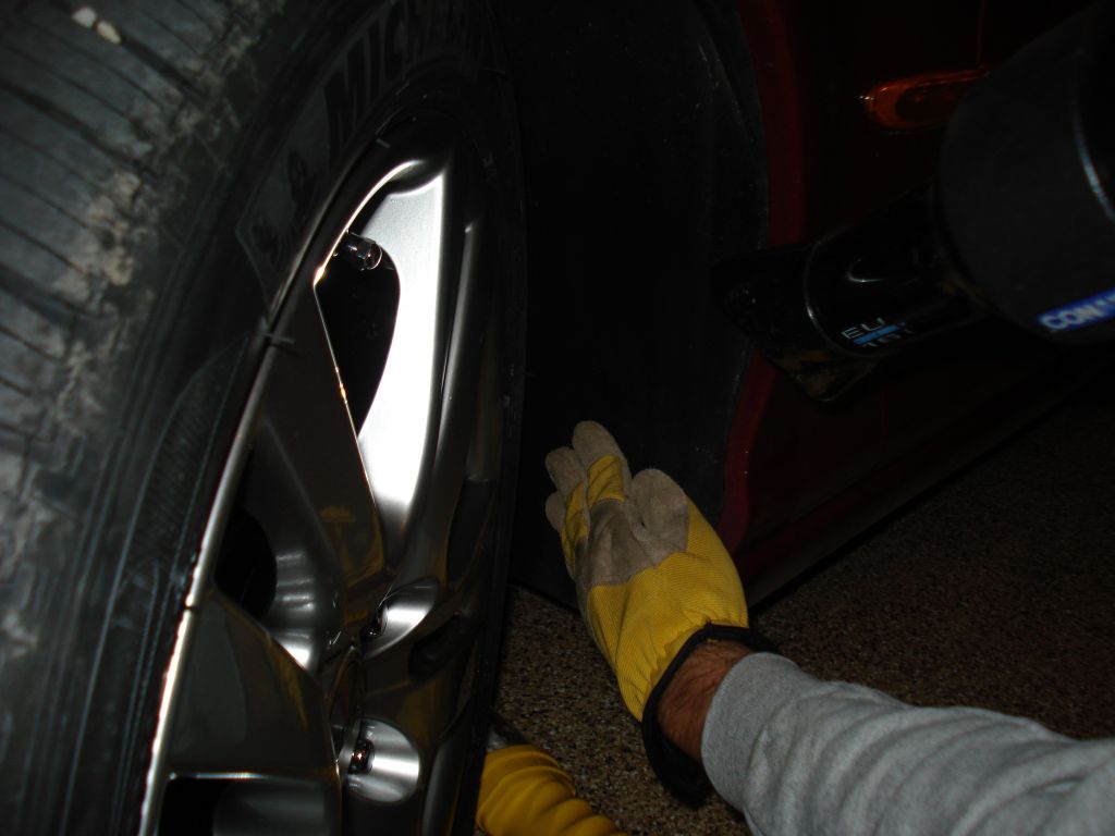

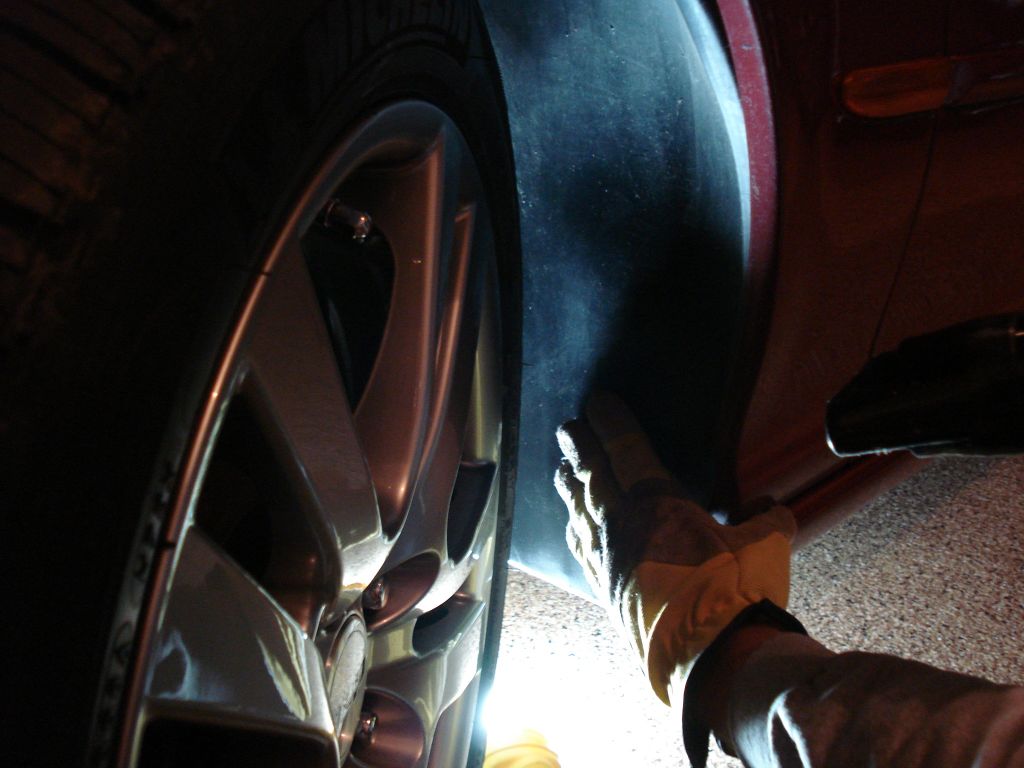

The rubbing problem was present when the wheel was at max turn.
What I did:
I've grabbed my hair dryer and I start to heat the interior liner. With the other hand I have started to "massage" the liner towards the interior keeping in mind that I do not need to affect the rest of the liner (the top for example has the tendency to go down (when you heat and push back).
When I was sure that it is enough, I have kept my hand in there still pushing untill the plastic cooled off to be sure it will remain like that.
As a note, I really don't know what others are thinking but from my point of view this is the max you can go with the wheels on this car. If you go wider than that you will have big issues.
Attached Thumbnails 2003 X-Type wheels advice-07.jpg   2003 X-Type wheels advice-08.jpg   2003 X-Type wheels advice-09.jpg

You can go with bigger rims, you just need to compensate with a shorter profile tire. The goal is to keep the same overall diameter, or close to it, as stock. You are just swapping rubber for metal.
anyway, nice work Tracus. Rubbing at max turn is not a big deal. It's not good for the power steering pump to be held at max turn anyway. Looks like you got it fixed without much difficulty.
