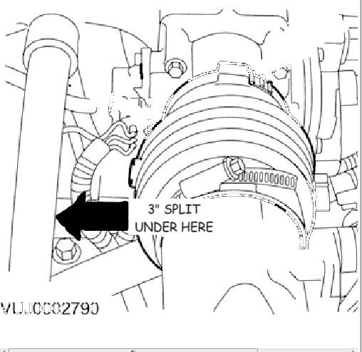

Hello I am new and have owned an Xtype for the past 3 years, lately I have had some issues come up that I need help with. I have just replaced the spark plugs and will be replacing the air filter as soon as one comes in. The car is idling rough when cold and is making a popping noise and if you cover the air intake you can feel a blow back when it makes this noise. Also when you first start driving and you have too sit at lights for a couple of min, when you drive off again it will not go past 2500 revs and missies badly. In a couple of minutes it will clear and start to accelerate smoothly again.

Assuming ithas beenserviced at least as per the schedule and the air filter doesnt fix, have a look at this as it only takes a minute and common fault according to dealer.
Remove the 3 screws holding the engine plastic cover on, remove it and check this pipe....many split and a sturdier one is £5 from the dealer...
If that doesnt sort it maybe need to get codes read to pinpoint problem?

Thank you for the help this pipe is split and I shall contact the dealer tomorrow to get the part.

..in the meantime you can tape around the pipe with strong tape until you get a new one which will allow to run OK.
If there isan engine light on the dash this should go out after around 3 cold-hot start cycles.

I have contacted my dealer on the Gold Coast Australia and they want $115 for the £5 part, can you suggest an on on line parts supplier I could use as all parts sold here seem to be rather more expensive than overseas. Also I could not read the part no properly could you please clarify so I order the correct part. The split is just below the pipe in the diagram in a larger rubber hose that this pipe connects to.
Regards
Jeffre
The pipe shown in the diagram is the inlet manifold-rocker cover breather pipe
The part number is C2S40863
It cost £4.37 + vat (now 15%) over here (UK) in Aug
